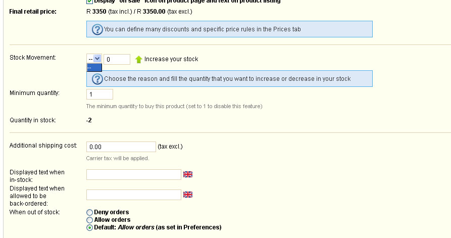

enock Posted October 26, 2011 Share Posted October 26, 2011 Hi Guys, I can see you have found a solution to the problem. I just have a slightly different issue with Stock Movement. It doesn't have any values in the combo box. Please see the screenshot attached. How do I get values in there? I'm using version 1.4.0.17 Link to comment Share on other sites More sharing options...
