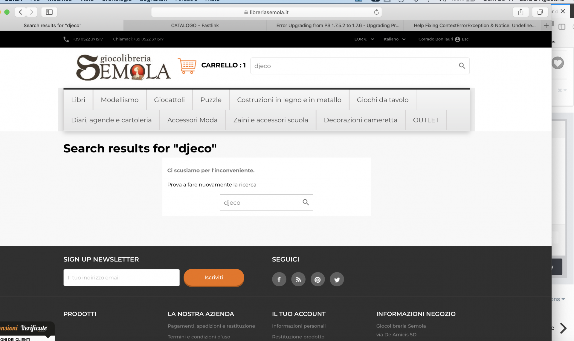

I have an issue with the search bar of my shop www.libreriasemola.it
I used to run Prestashop 1.7.3 - and today updated to PS 1.7.6.5 in order to see if the problem could be solved, but it is not.
the matter is simple: search bar displays no results.
I tried to:
- rebuild index form BO Search panel
- Clear cache
- Truncate ps_search_index table in database (and then restored from backup as nothing changed)
I also installed an ajax search module (joli search) but it does not return any result.
Any suggestion?
thank you in advance!

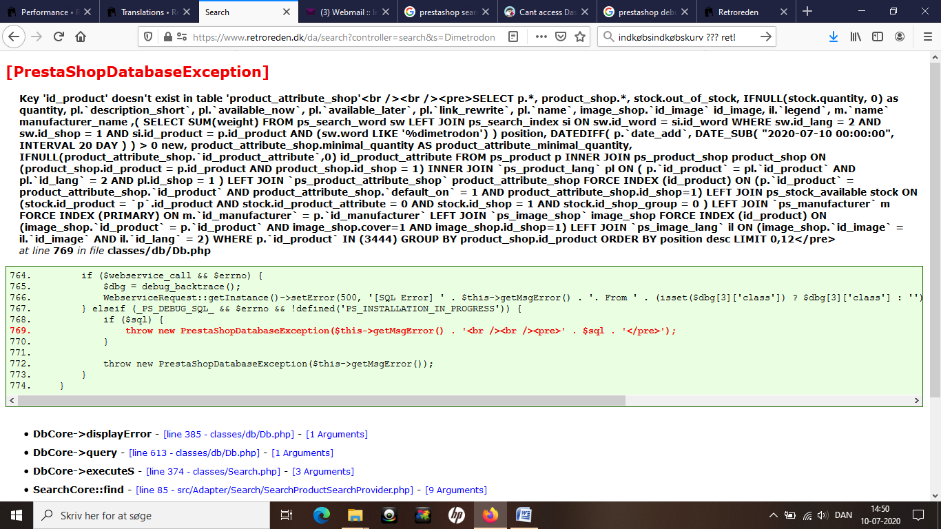

Thank you very much for trying to help. I installed the PSCleaner module just now and ran "functional integrity constraints" and "Database cleaning" but unfortunately the search bar in FO is still not working.
Regarding removing all entries with the product id 3444 (the item I made a search for) from all the ps_product tables. It doesn't matter what product I search for I get the same message in debug mode just with a new product id for a different product of course. So that would mean deleting all entries from all my products? I got around 3000 😮

After some debuging, I've managed to get the search sql query and after putting it into phpmyadmin I got this error.
#1176 - Key 'id_product' doesn't exist in table 'product_attribute_shop'
So after adding index to the mentioned field, I was able to solve this problem.
The query to add the index:
ALTER TABLE `ps_product_attribute_shop` ADD INDEX(`id_product`)
P.S. after writing this message I noticed that same exact error message was mentioned in this thread by Anders N. on July 10, 2020 (with added prestashop error message).
