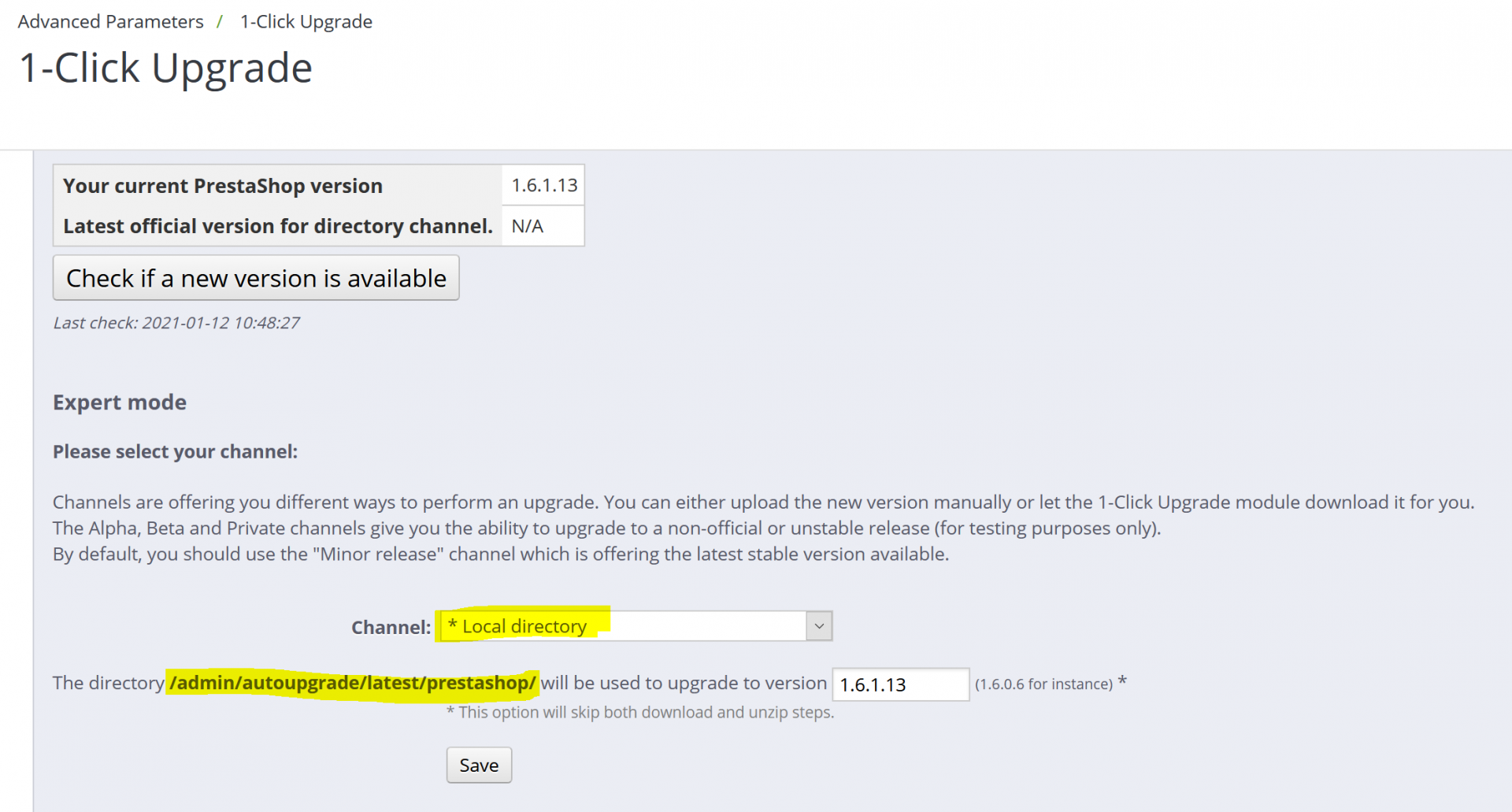

glennlawre Posted January 12, 2021 Author Share Posted January 12, 2021 As this was over 1 year ago, I'm trying to remember exactly what I did... As far as I recall, I think I used the Auto-Upgrade module and selected the "*Local directory" option to complete the upgrade. To do this you need to upload an un-zipped version of the install files (for the version you want to upgrade to) to the directory highlighted in the image below and then select the various options before clicking to perform the update. Just be sure to do a full back-up of all files and your DB before attempting as I have had this fail in the past and had to restore. I hope this helps... Link to comment Share on other sites More sharing options...
Akileine13 Posted January 12, 2021 Share Posted January 12, 2021 thanks for your response, but i have this problem : I am trying to update a PS v1.6.0.6 site via the 1-Click Upgrade module and I am seeing the below error when I click "Configure" on the module. Fatal error: require(): Failed opening required '/' (include_path='.:/opt/alt/php70/usr/share/pear') in /classes/PrestaShopAutoload.php on line 122 I tested the module, but I have the same error thanks Link to comment Share on other sites More sharing options...
glennlawre Posted January 12, 2021 Author Share Posted January 12, 2021 I have also had many problems with this module over the years and there never seemed to be much support on it. Given it's an official PS module it really should have better support from PS. All I can recommend to do in this case is to get the original module files, maybe for a different version, and replace these in your "modules" folder. You might need to download a version of PS to get the original module files from the extraction. Or you might be able to find a download of just the module files somewhere. I have had to do this in the past to get over issues with this module.. If this doesn't work and you can't resolve the issue with the module you may be looking at a complete "manual" upgrade which involves downloading the site and running locally using WAMP or similar and updating before re-uploading back to your site. Messy process but sometimes required... There's documentation on this on the PS site. Let me know if you can't find and I'll dig out s link. Link to comment Share on other sites More sharing options...
