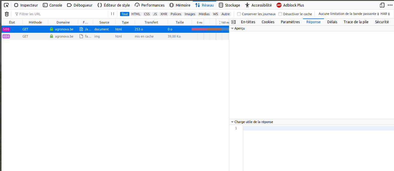

Stéphane V Posted May 3, 2019 Share Posted May 3, 2019 (edited) HI, Using Prestashop 1.7.5.1 with a 1-click install on OVH : I can access to the public shop : OK I can't access to the admin URL : Error 500, without any message, (followed by a Error 404 for the favicon, i think this is not the issue) I activated the debug mode in config/defines.inc.php with define('_PS_MODE_DEV_', true); And I got the complete access to the admin area, without any Error 500... Where is the error gone ? --> If I revert _PS_MODE_DEV_ to false, I get the error 500 back, even when deactivating all non-prestashop modules and putting the default theme... I did not find any error 500 in the server log (even when it happens with _PS_MODE_DEV_ set to false). How can I diagnose such an error ? Any idea ? I take in consideration even the "fancy" ideas... because I have no more ideas to solve this.... Edited May 3, 2019 by Stéphane V (see edit history) Link to comment Share on other sites More sharing options...

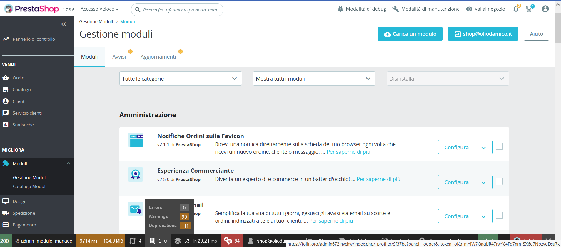

oliodamico Posted October 26, 2022 Share Posted October 26, 2022 Hi I have the same problem with prestashop 1.7.8.6. If I go into modules page whitout debug mode on I have e white page , If I go to the modules page after enabling debug mode, I can open the page. I have cleared and deleted the folder in /var/cache/ and all the folder/files permission are set to 0755 0644 How can I fix the problem ? With debug mode on I haven't any error: Link to comment Share on other sites More sharing options...
