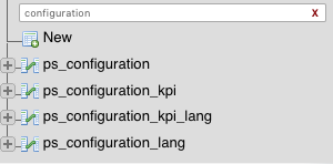

Davide Posted November 20, 2018 Share Posted November 20, 2018 8 minutes ago, jordy971 said: Where did you enter the values manually ? where is Prefix_Configuration ? `ps_configuration` is a table, check your database. `ps_` is the default PREFIX that you can change during the installation. Link to comment Share on other sites More sharing options...

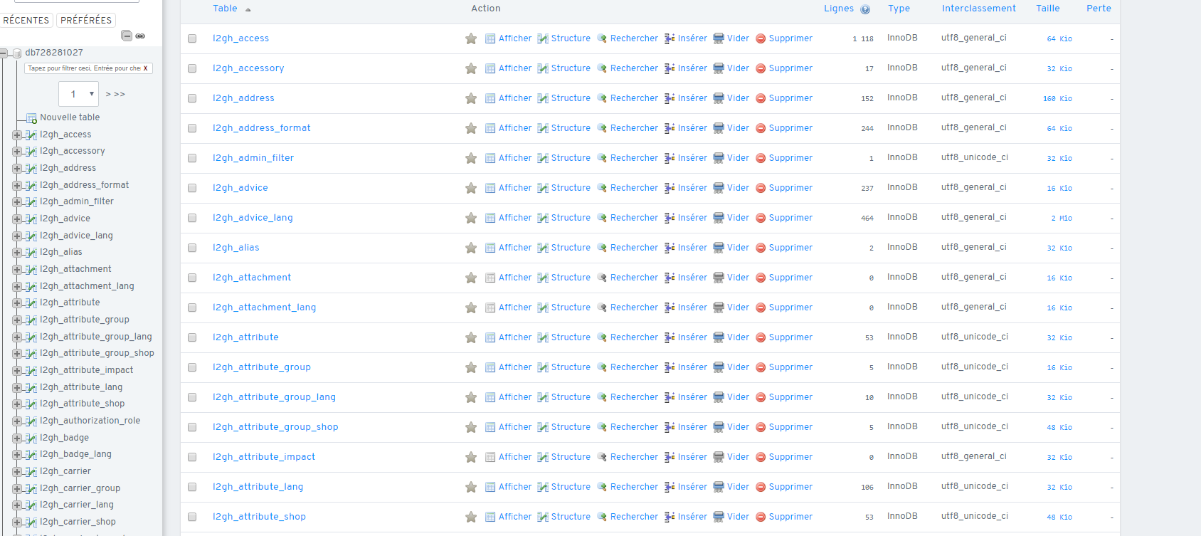

jordy971 Posted November 20, 2018 Share Posted November 20, 2018 I don't have "ps_" Look what is in my database phpMyAdmin Thank you for you're help Link to comment Share on other sites More sharing options...
Davide Posted November 20, 2018 Share Posted November 20, 2018 7 minutes ago, jordy971 said: I don't have "ps_" Look what is in my database phpMyAdmin your `prefix` is `l2gh`, your table will be l2gh_configuration Link to comment Share on other sites More sharing options...
jordy971 Posted November 20, 2018 Share Posted November 20, 2018 Unfortunately i don't have l2gh_configuration That's really strange maybe that's my problem ? Link to comment Share on other sites More sharing options...

Davide Posted November 20, 2018 Share Posted November 20, 2018 1 minute ago, jordy971 said: I'm on 1.7.4 too Under DB name, click into text input, write `configuration` and press ENTER to search. If the table is not listed..... I don't know Can you try a clean install? Link to comment Share on other sites More sharing options...
jordy971 Posted November 20, 2018 Share Posted November 20, 2018 Thank you i've found the configuration files, But even when I turn ON the sandbox I have the same error than MrTini So unfortunately I don't think this will resolve my issue Link to comment Share on other sites More sharing options...

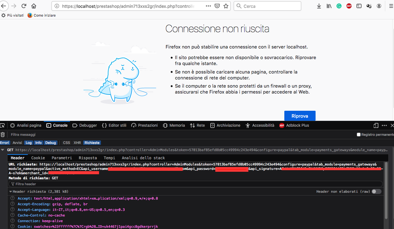

carminoplata Posted June 20, 2019 Share Posted June 20, 2019 Hello everybody, I am dealing with similar problems on Paypal module. Practically, the first time, I tried to activate Paypal service (no Braintree) without the flag for sandbox but I didn't want to complete it. So I found a manual as a user guide for the configuration of the module, and I tried to follow it. I activated the Sandbox flag and then I tried to login and associate my sandbox account with the Business profile. When I click on Authorize button to provide information for Paypal API and I come back to Prestashop, I get a 500 Internal Server Error but the data in the request are correct. Could it be due to the use of localhost and not a production server (hosting for example)? there is a screenshot of the results of the request at Paypal in attachment. I tried also to update manually the fields into DB but it hasn't solved my problem yet. Thanks a lot for your reply and support Link to comment Share on other sites More sharing options...
