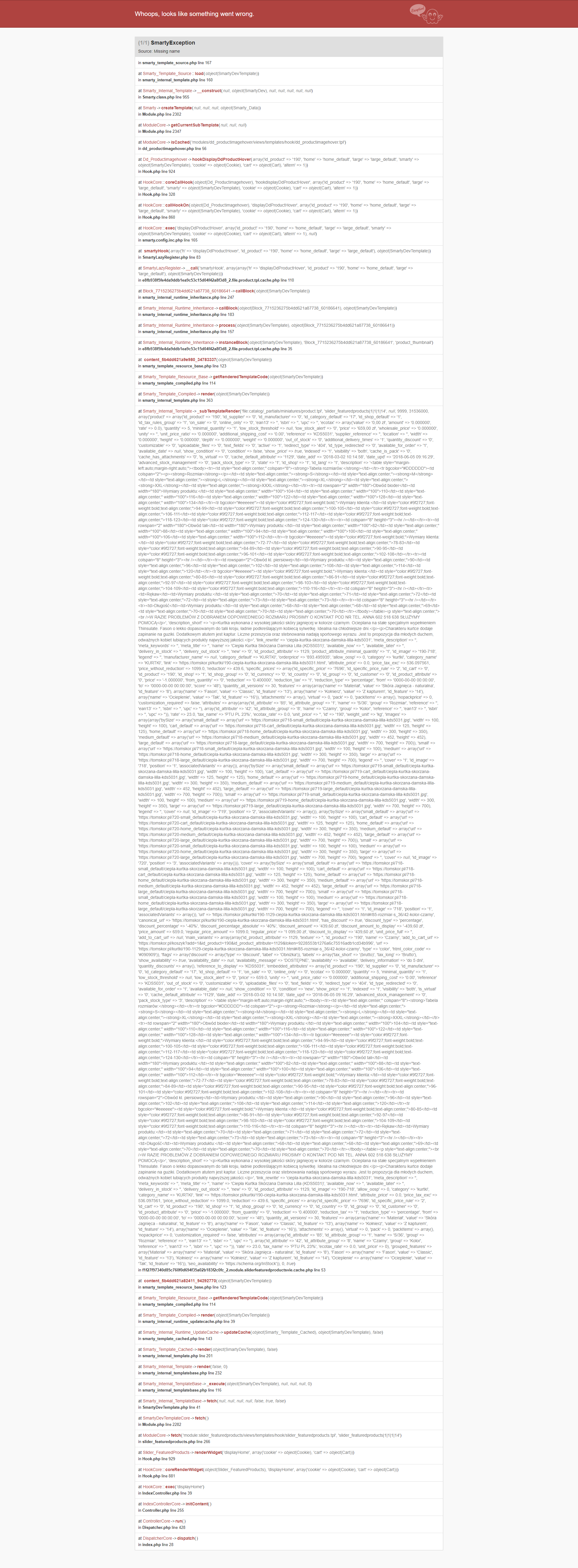

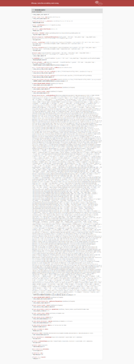

Tomskór Posted July 17, 2018 Share Posted July 17, 2018 Today I upgrade my presta from 1.7.3.3 version to 1.7.4.1 and after that it works... but only on classic theme when I change on my custom theme fatal error appear. How I can fix it? I trying to back to 1.7.3.3v on 1 click upgrade but after few second proceed stops and nothing happend, and when I refresh everything gone. Link to comment Share on other sites More sharing options...
