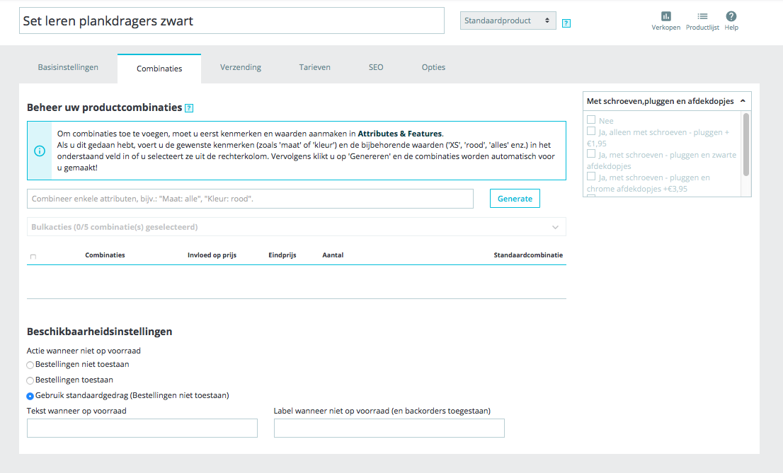

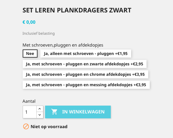

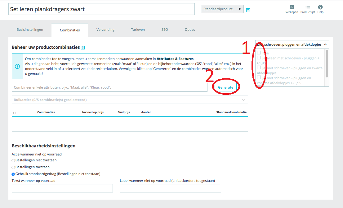

I install prestashop version 1.7.3 and add new products. The products have a lot of combinations. I see the combinations on my product page (see screenshot)
When i update a product with combinations, then we get a problem. I see nog longer the products on the backoffice. (see screenshot),
The product is not longer working on the backoffice.
Can maybe somebody help me with this problem?
Thanks for helping.

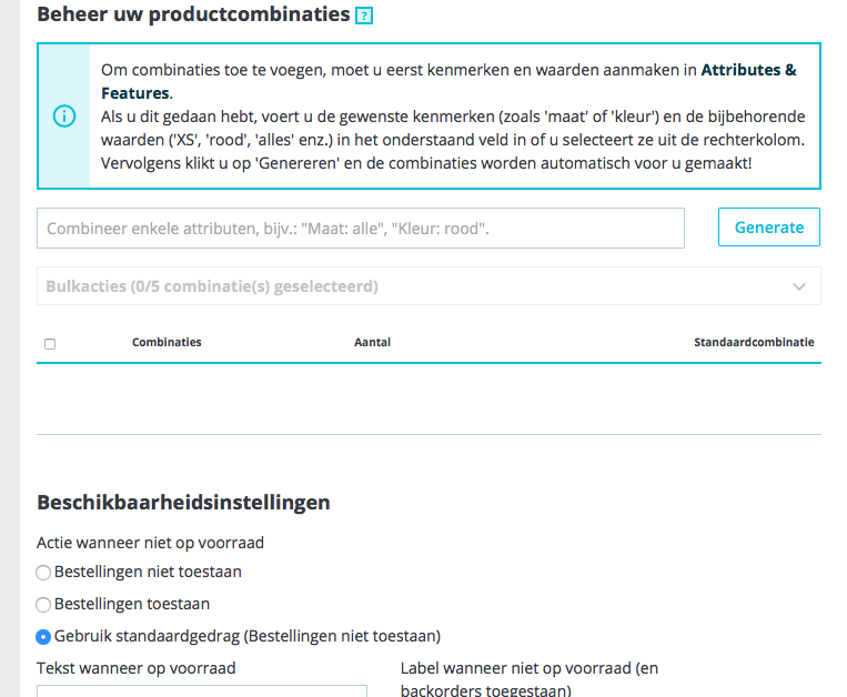

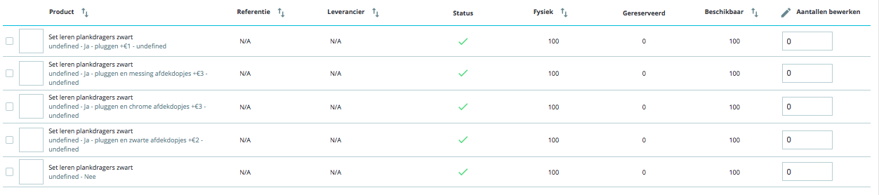

No, i have the  Look my new screenshots.
I see the combinations not on the backoffice of the products. that is the problem
I see only the combinations on my stock page. and the products have a quantity of 100.5abcd8b88ea33_Schermafbeelding2018-03-29om14_14_04.thumb.png.aa183aacabff91e9a5d660ed8f2f2698.png5abcd94f10605_Schermafbeelding2018-03-29om14_15_12.thumb.png.a01b0e254bd6a37cf0b760d5e6928edb.png

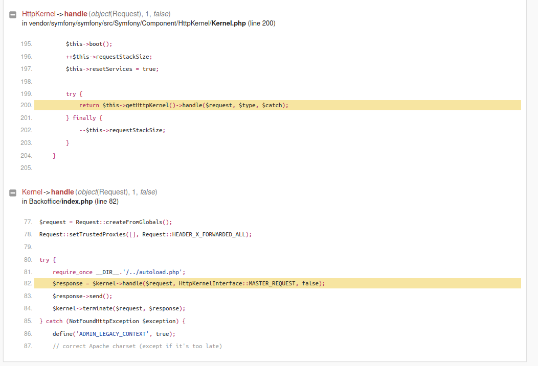

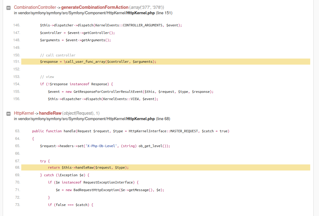

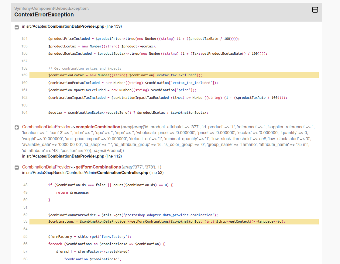

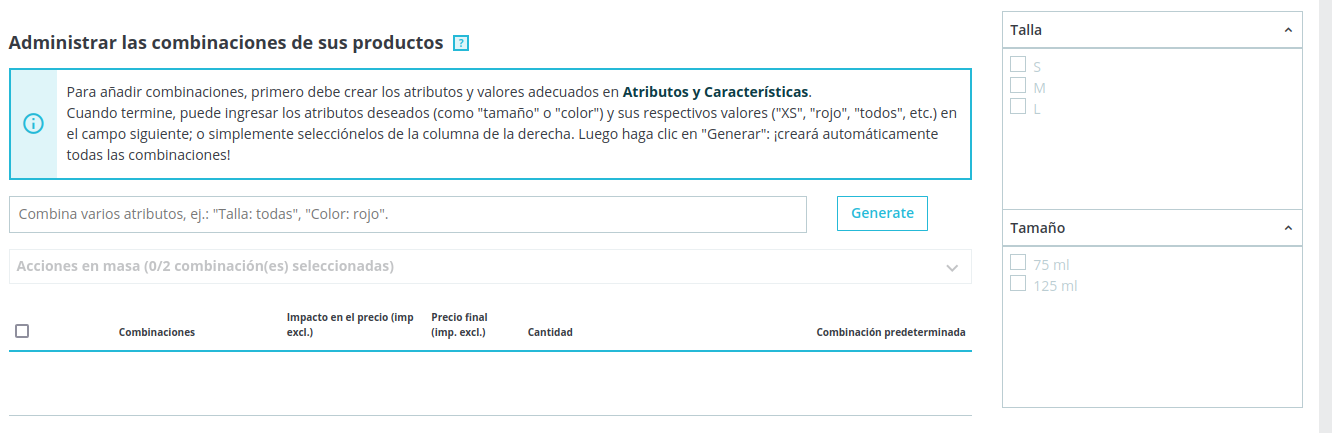

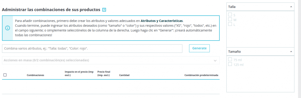

On the admin side when you go to the "Combination" Tab the combinations generated did not appear.
I am attaching the view, and the mistakes (3/3)
