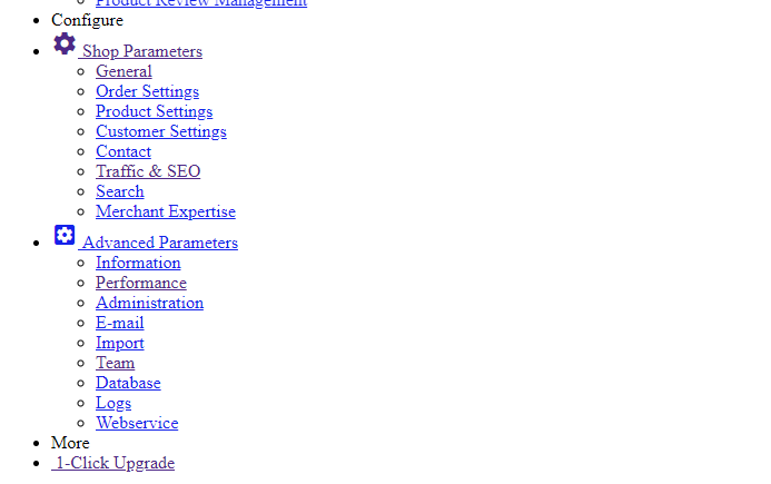

Timon Posted March 2, 2018 Share Posted March 2, 2018 Hi community, I have run into an issue moving the shop from public SSL page to onpremise. The version is 1.7.5 The issue is that the Backoffice in general not is loaded correct on the most pages - it missing its CSS. But forinstance on Installed Modules the page is loaded correct. I have been done the following: - Followed a guide on moving to onpremise (configure correct db, username and password) - Clearing the cache - Updating the .htaccess - Updating the database setting under ps_shop_shop_url - domain, domain_ssl and physical_uri ps_configuration - PS_SHOP_DOMAIN and PS_SHOP_DOMAIN_SSL. - Set SSL to false in the AuthController.php (not sure this is needed) - Recompile the site under performance I have tried to set the site in debug mode and enabled display_errors. I have also tried to remove all modules and themes that have been added to the shop. I tried to located the CSS in the page contents (not sure what to look for here) and I also tried different browsers. None of the things I tried have impacted the missing CSS on the Backoffice. I have a local installed Prestashop site running on the computer with version 1.7.3 - there everything works fine. Anyone have an idea of what could be missing then I would like to hear from you? (I do this to test upgrading the shop to 1.7.3 - I failed on the live shop) Link to comment Share on other sites More sharing options...
