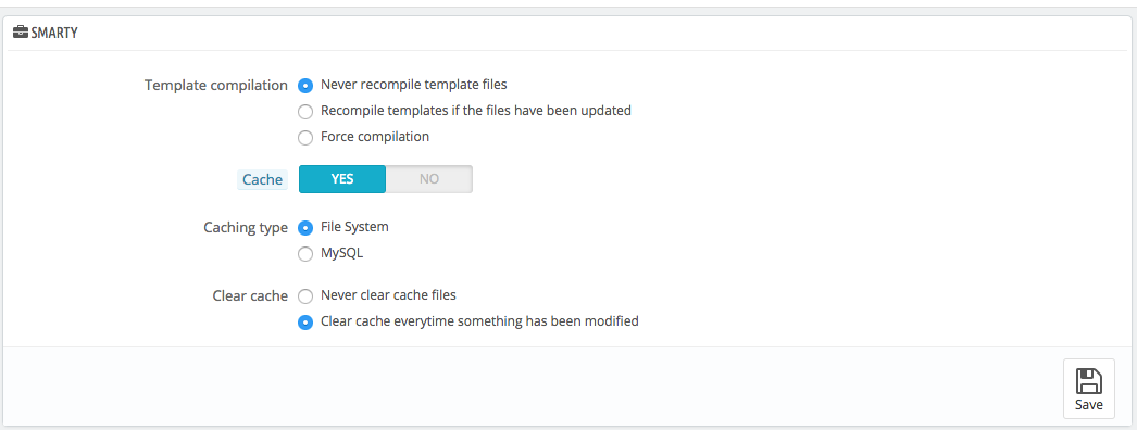

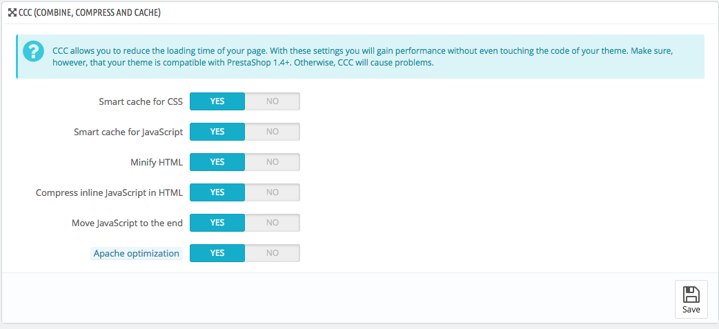

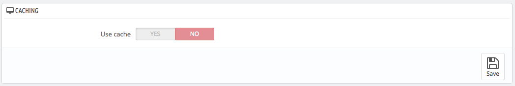

Max B Posted March 11, 2018 Author Share Posted March 11, 2018 On 2/24/2018 at 11:03 PM, El Patron said: do you have any caching set bottom of your performance page? I thank you dearly for your prompt response and apologize for my delayed one. These are my cache settings under "performance". Is it possible that any of my settings forces my Localization settings to reset automatically every time there's a modification or every few weeks? Or would it be a problem on the server side? - By the way, I own 2 websites under the same hosting service (godaddy) and settings were reset on both websites. Link to comment Share on other sites More sharing options...
PrestaHeroes.com Posted March 26, 2018 Share Posted March 26, 2018 I do not recommend using 'file system cache'...unless when working in back office you turn it off. I used to have free module that would warn in bo file cache active, so it could be disabled while working in back office...and the reverse, when off it would prompt to re-enable when you are done with admin changes.. so when working in back office turn off file system cache. also WTF PRESTASHOP WITH HAVING TO SELECT NOTIFY ME OF REPLIES AS 'NO' DEFAULT.....IDIOTS! WAY TO RUIN THE COMMUNITY 1 Link to comment Share on other sites More sharing options...
Max B Posted March 31, 2018 Author Share Posted March 31, 2018 On 3/27/2018 at 3:29 AM, El Patron said: I do not recommend using 'file system cache'...unless when working in back office you turn it off. El Patron, thank you for kindly responding to my question!! I want to clarify, when I work in my back-office, I should switch the caching type to MySQL? And when I finish working in my back-office, should I switch back to File System? Thank you! Link to comment Share on other sites More sharing options...
PrestaHeroes.com Posted April 1, 2018 Share Posted April 1, 2018 19 hours ago, Max B said: El Patron, thank you for kindly responding to my question!! I want to clarify, when I work in my back-office, I should switch the caching type to MySQL? And when I finish working in my back-office, should I switch back to File System? Thank you! Hi, no...simply set to No while working in back office then set to Yes when done. https://www.screencast.com/t/graeVc9XQL 1 Link to comment Share on other sites More sharing options...
Max B Posted April 1, 2018 Author Share Posted April 1, 2018 2 hours ago, El Patron said: Hi, no...simply set to No while working in back office then set to Yes when done. https://www.screencast.com/t/graeVc9XQL Thanks El Patron, I'll set Cache to "NO" while working in back office! With regards to "LOCALIZATION" settings automatically being reset every few weeks/months - should I contact GoDaddy to see whether they automatically refresh their servers? Link to comment Share on other sites More sharing options...
PrestaHeroes.com Posted April 1, 2018 Share Posted April 1, 2018 1 minute ago, Max B said: Thanks El Patron, I'll set Cache to "NO" while working in back office! With regards to "LOCALIZATION" settings automatically being reset every few weeks/months - should I contact GoDaddy to see whether they automatically refresh their servers? you can ask them if they are running a cache you 'do not see', like varnish. explain to them you are running ecommerce and cache can create unpredictable results in cart process. also consider if using shared to move to vps....I recommend Liquid Web storm managed vps's or dedicated but i do not know your local at the end of day....ecommerce is 'not static' content....hosting is set up for wordpress....which is static and does not fall over when cache used. all should also heed this warning: module cache's in ps eco...WILL BREAK YOU SHOP....do not use voodoo....use faster hardware. Cheers, el 1 Link to comment Share on other sites More sharing options...
