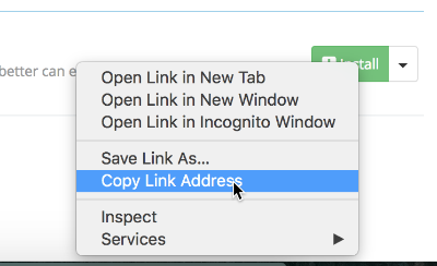

DataKick Posted February 15, 2018 Share Posted February 15, 2018 That is strange indeed. It really sounds like there's something wrong with your system. At the moment I can offer you only following solutions (hopefully it will work): 1) open module list and find your module 2) right click mouse on install button, and select copy link url 3) paste the copied link to url bar, and replace 'install' with 'uninstall', and hit enter That should trigger uninstall process... Link to comment Share on other sites More sharing options...
