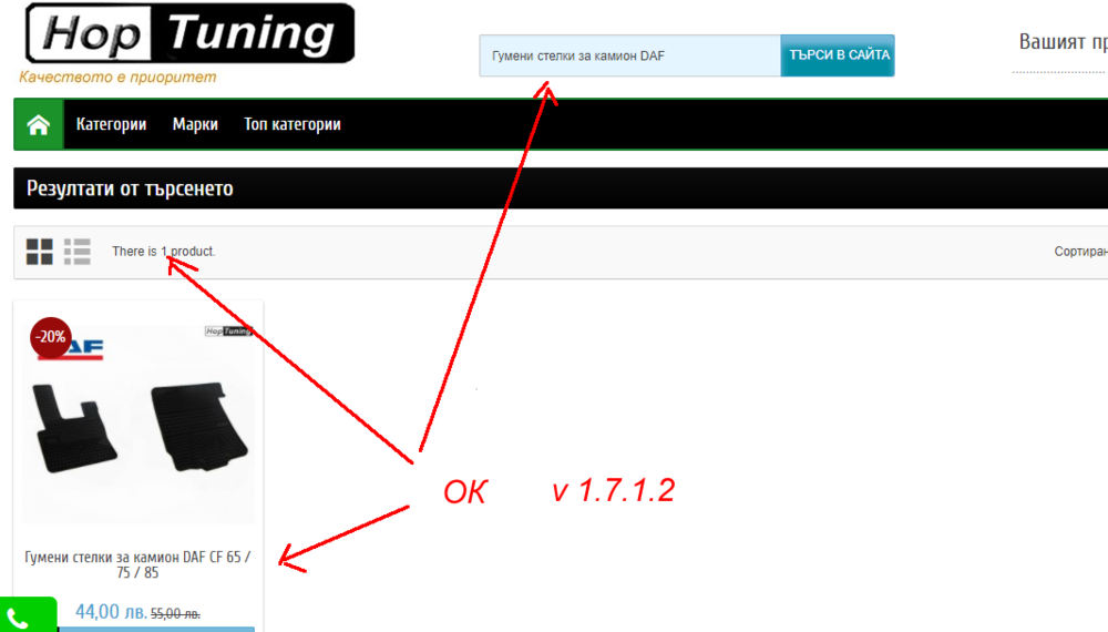

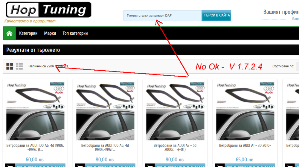

I use Prestashop 1.7.2.4. When searching for certain words, it produces a lot of results, even when searching for exact phrases and product sentences, it produces hundreds of unnecessary results (version 1.7.1.2 did not have this problem). To bypass a problem I changed the class /Search.php with old version. at the same time does not show the product category in the search box as it was in version 1.7.1.2 ... .. For snippets I will upload photos
https://hoptuning.bg
  • Like 1
I don't like that search module either. It searches in many columns from product and category tables. This produces a lot of results. In addition, PS shows first the category in the results list, the searched word being often not present in the list, giving the impression that the search is wrong. Now, we're used to Google search which is incredibly clever in guessing what we meant...
When I have time, I plan to write my own search module. I let you know ;).
  • Like 2

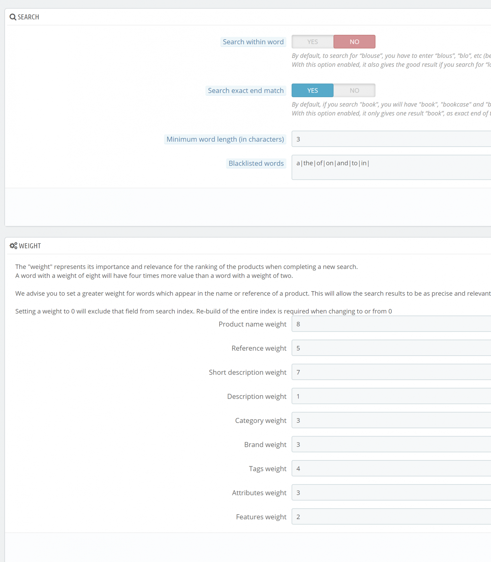

Hi Inkton,
We are also on Prestashop 1.7.5.1 and search is working perfect.
Based on Bolean seach AND function, will find products which have all the words visitor did add in the search field. i.e. "love" AND "hate" AND "relation".
Further in admin  under 'settings/search'  you can adjust the weight (value) you put into search (title, discription, tags) and also
search "in a word" or not
and search for exact  word end.
Select and test what gives the best results.
On our site, we found best result with setting :  "search in the word" =  off and "seach for exact end " on.

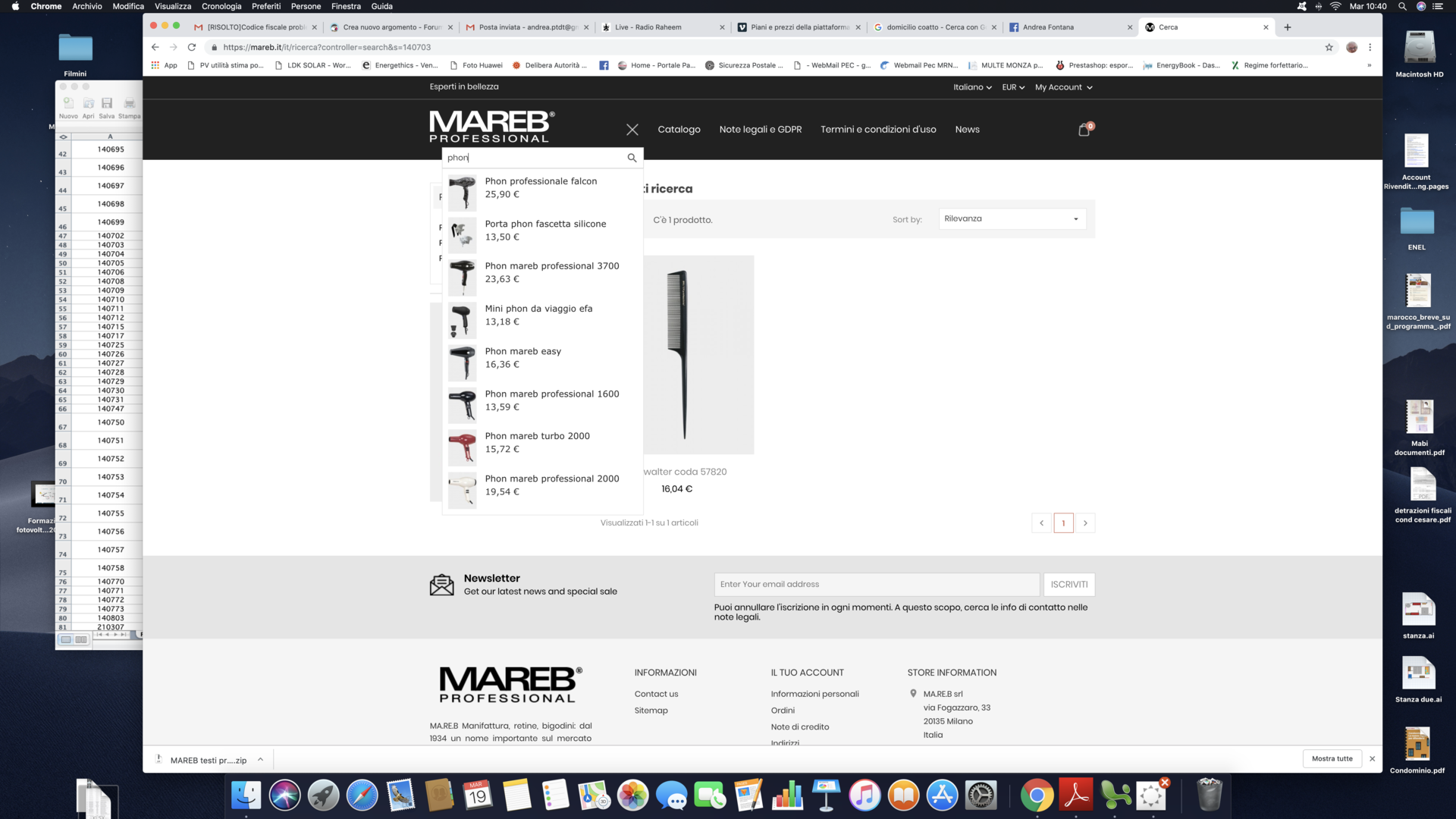

It's not about whether it works or not just what I'm showing. I joined screen. What I would not typed shows me something like that
42 minutes ago, peter4661 said:
I attached the working file from our site. "search-PHP modified".
You need to rename the file to search.php.
Make sure to clear all your cache file after installation of the new search file and re-index ( admin : settings/search )
Search_PHP modified.php
Ok, now he does not make any mistakes. I have not rebuilt the index before. But I have a question, why can not I find some things? For example, I have a product with the title "Byzantine table from teak wood". I would like to start displaying this subject to me after entering "Byz", but it does not work until I type in the whole word. I have so many objects and for now I do everything manually adding aliases, but this is not a solution. Does anyone know why this is so?

8 minutes ago, peter4661 said:
For getting search results while you type,  disable setting "search for exact end" , under settings/seach.
See if this gives you the desired results in combination with "search in word" (on/off)
Finally, thank you, it was so easy. Life saver.

On 1/13/2018 at 3:10 PM, peter-D said:
Hi Mustang80,
We are also on PS 1.7.2.4 and had the same problem.
With help of  tips at https://www.prestashop.com/forums/topic/597944-search-two-or-more-words/?tab=comments#comment-2631092
we modified the file classes/seach.php.  This solved the problem in our site. Seach is getting exact results now.
Attached the modified search.php file.  Rename the file to search.php and upload to your server.
Best regards,
Peter
PS-1.7.2-modified-for-or_Search.php
Thank you very much!
Running PrestaShop 1.7.8.0 and everything works great!
  • Like 1
  • Thanks 1

On 8/26/2021 at 12:18 AM, JavierP said:
any updates or solutions here? for 1.7.7.5 The prestashop search engine leaves much to be desired .....
especially for searches by tags it is heating my head ...
Hello, I have tried this free module and it works perfectly on P.S. 1.7.7.8:
https://bontheme.com/prestashop-modules/design-navigation/live-search-product-ajax-free-prestashop-module
Hope that helps!

I uploaded the file to public html/classes/search.php
I saved a copy of the old search.php
My backoffice no longer works and neither is my website
Tried restoring the old Search.php file
Still no backoffice or website back
Im now restoring the entire site from backup

Hello,
I tested the file on both sites, I cleared the cache (site and browser) and rebuild the search index.
outils.expert -> 1.7.6.9 -> Theme Autotricks 1.0
Result : Once the Search.php file is replaced, the preview results from the theme search bar is not good but when I type "enter" or "more results", the results are not good either, they are the same. If I search "Socket SAE", I get "Socket" OR "SAE" in the preview and in the final result. It seems like if the search bar is overriding the Search.php file.
remorque.expert -> 1.7.8.7 -> Theme Autotricks 2.0
Result : Once the Search.php file is replaced, the preview from results the theme search bar is not good but when I type "enter" or "more results", the results are perfect. If I search "Aluminum fender", I get only aluminum AND fender in the results (not Aluminum OR fender). The previewed results are bad but the results are good. I'll work on this later.
If there is any developer out there willing to help to fix this, I would be very grateful.
