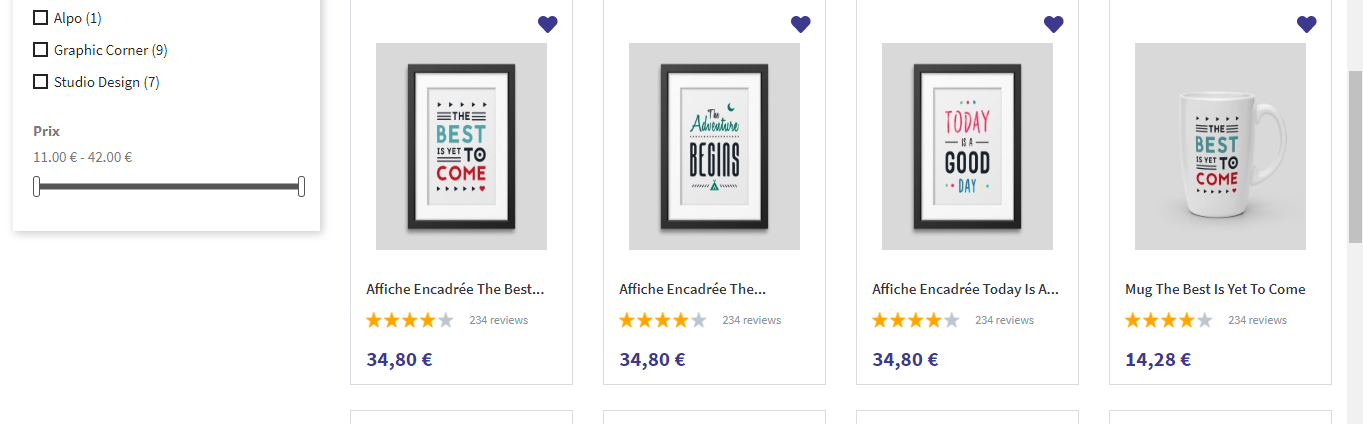

sidney712 Posted May 10, 2019 Share Posted May 10, 2019 (edited) jQuery UI slider for price filter. It's my temporary solution. I use it with my theme based on Classic. In this file  sitename/themes/classic/templates/catalog/_partials/facets.tpl after the string   {if $facet.widgetType !== 'dropdown'} insert this {if $facet.type == 'price'} <div class="slider-range-wrapper"> <p> <input type="text" id="amount" readonly> <a id="submitprice"> <button class="btn btn-secondary">OK</button> </a> </p> <div id="slider-range" data-type="{$facet.type}" data-quantity="{$filter.magnitude}" data-min-value="{$facet.properties.min}" data-max-value="{$facet.properties.max}"></div> </div> {/if} and at the end of the file add this script <script type="text/javascript"> $('#search_filters').ready(function() { var langShop = prestashop.language.iso_code; var langPrice = $('.slider-range-wrapper').parent().children('.facet-title')[0].innerHTML; var pageURLIndex = -1; var sliderPrice = function() { var minValue = $('#slider-range').data('min-value'); var maxValue = $('#slider-range').data('max-value'); $('#slider-range').slider({ range: true, min: minValue, max: maxValue, values: [minValue, maxValue], slide: function(event, ui) { $('#amount').val(ui.values[0] + ' ' + prestashop.currency.sign + ' - ' + ui.values[1] + ' ' + prestashop.currency.sign); }, stop: function(event, ui) { pageURLIndex = window.location.href.indexOf("?"); $('#amount').val(ui.values[0] + ' ' + prestashop.currency.sign + ' - ' + ui.values[1] + ' ' + prestashop.currency.sign); $('#submitprice').attr("href", window.location.href + ((pageURLIndex === -1) ? '?q=' : '/') + langPrice + '-' + prestashop.currency.sign + '-' + $('#slider-range').slider('values', 0) + '-' + $('#slider-range').slider('values', 1)); } }); $('#amount').val($('#slider-range').slider('values', 0) + ' ' + prestashop.currency.sign + ' - ' + $(' #slider-range').slider('values', 1) + ' ' + prestashop.currency.sign); }; sliderPrice(); }); </script>  Edited May 23, 2019 by sidney712 (see edit history) Link to comment Share on other sites More sharing options...
datshay Posted May 13, 2019 Share Posted May 13, 2019 On 5/10/2019 at 7:30 PM, sidney712 said: jQuery UI slider for price filter. It's my temporary solution. I use it with my theme based on Classic. In this file  sitename/themes/classic/templates/catalog/_partials/facets.tpl after the string   {if $facet.widgetType !== 'dropdown'} insert this {if $facet.type == 'price'} <div class="slider-range-wrapper"> <p> <input type="text" id="amount" readonly> <a id="submitprice"> <button class="btn btn-secondary">OK</button> </a> </p> <div id="slider-range" data-type="{$facet.type}" data-quantity="{$filter.magnitude}" data-min-value="{$facet.properties.min}" data-max-value="{$facet.properties.max}"></div> </div> {/if} and at the end of the file add this script <script type="text/javascript"> $('#search_filters').ready(function() { var langShop = prestashop.language.iso_code; switch (langShop) { case 'fr': langPrice = 'Prix'; break; case 'ru': langPrice = 'Цена'; break; case 'uk': langPrice = 'Ціна'; break; default: langPrice = 'Price'; } var pageURLIndex = -1; var sliderPrice = function() { var minValue = $('#slider-range').data('min-value'); var maxValue = $('#slider-range').data('max-value'); $('#slider-range').slider({ range: true, min: minValue, max: maxValue, values: [minValue, maxValue], slide: function(event, ui) { $('#amount').val(ui.values[0] + ' ' + prestashop.currency.sign + ' - ' + ui.values[1] + ' ' + prestashop.currency.sign); }, stop: function(event, ui) { pageURLIndex = window.location.href.indexOf("?"); $('#amount').val(ui.values[0] + ' ' + prestashop.currency.sign + ' - ' + ui.values[1] + ' ' + prestashop.currency.sign); $('#submitprice').attr("href", window.location.href + ((pageURLIndex === -1) ? '?q=' : '/') + langPrice + '-' + prestashop.currency.sign + '-' + $('#slider-range').slider('values', 0) + '-' + $('#slider-range').slider('values', 1)); } }); $('#amount').val($('#slider-range').slider('values', 0) + ' ' + prestashop.currency.sign + ' - ' + $(' #slider-range').slider('values', 1) + ' ' + prestashop.currency.sign); }; sliderPrice(); }); </script>  I tried the code above, but it shows only OK button and a input field. No slider. Is it the full code? Link to comment Share on other sites More sharing options...
sidney712 Posted May 13, 2019 Share Posted May 13, 2019 (edited) datshay, it works if you include jQuery right after the comment in the file: sitename\themes\classic\templates\_partials\javascript.tpl Edited May 13, 2019 by sidney712 (see edit history) Link to comment Share on other sites More sharing options...
Amorino Posted May 23, 2019 Share Posted May 23, 2019 Nothing worked for me here Link to comment Share on other sites More sharing options...
sidney712 Posted June 1, 2019 Share Posted June 1, 2019 Price slider is built-in in the facetedsearch module ver 3.0.2 🙌😊 1 Link to comment Share on other sites More sharing options...

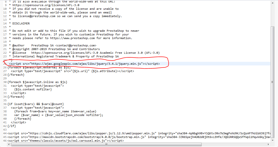

razorsharpshady Posted September 3, 2019 Share Posted September 3, 2019 (edited) I see where the error is. In the themes/classic/templates/_partials/javascript.tpl file the jquery is loaded in last few files. I just shifted it to up before all the js files are included in the same file and the price filter worked. The error that I was getting in the console was $(...).slider is not a function slider is a function of jquery ui , it must be loaded only after jquery, whereas in the default javascript.tpl file it was the opposite.  Edited September 3, 2019 by razorsharpshady (see edit history) Link to comment Share on other sites More sharing options...
