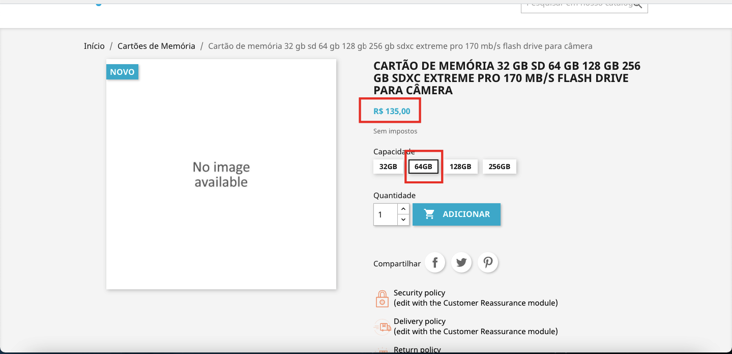

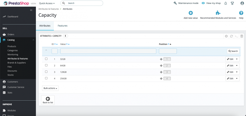

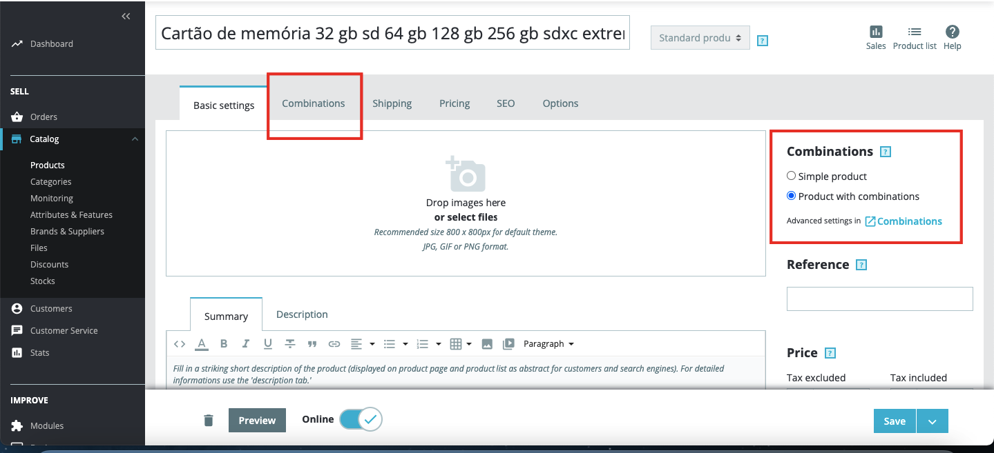

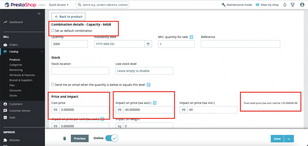

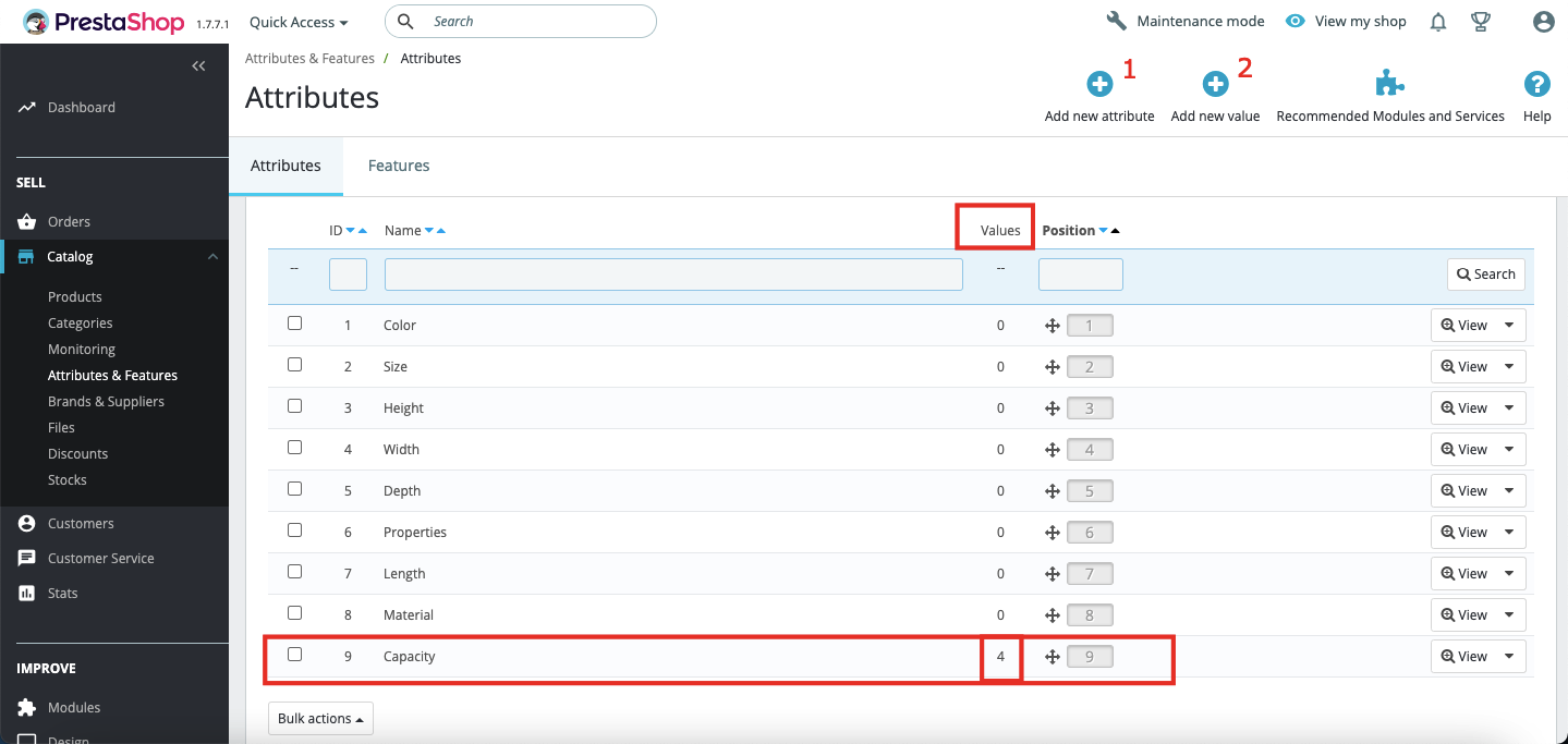

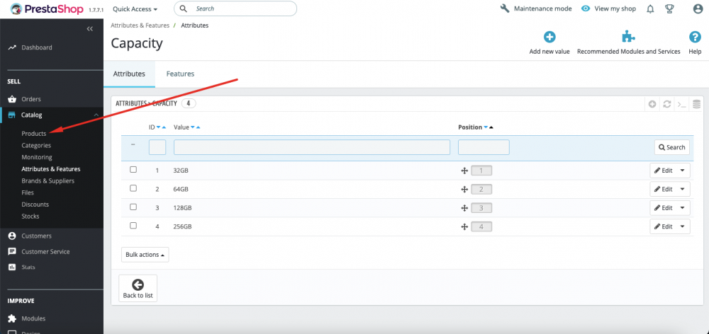

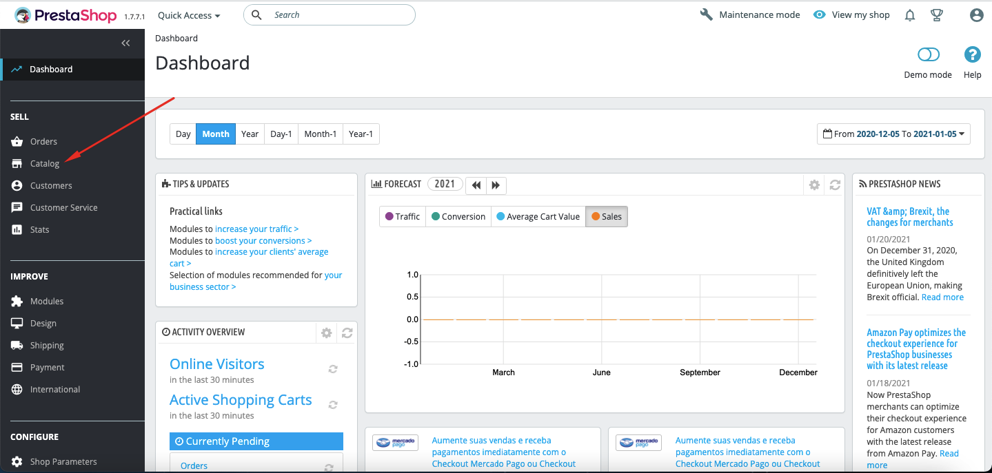

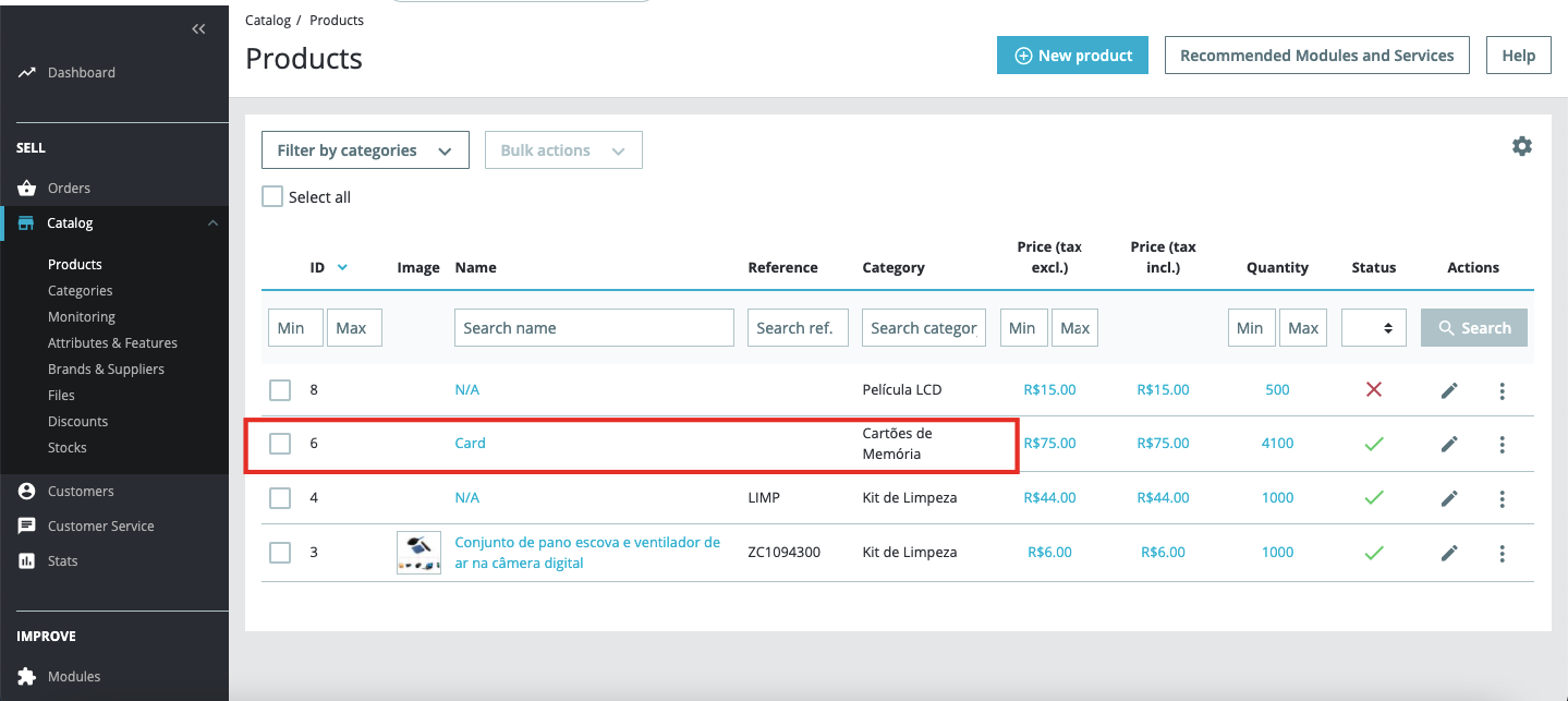

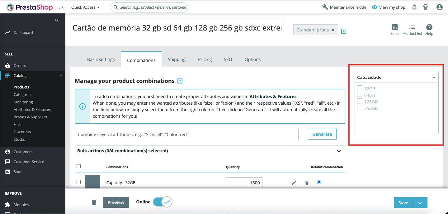

Hi guys, I'm a newbie with Prestashop 1.7. I think I found a solution without any new module. This test I did help me with for example a SD card with different capacities and higher prices for each capacity.
What I did:
Menu > Sell > Attributes & Features > Attributes > Create all Capacities AND the respective values
Menu > Product > New > Combination product menu > Select all capacities I want that are shown at right conner, example 32GB, 64GB, 128GB, 256GB
Combination product menu > At the combination area will show all combinations > Click each capacity to add quantity for and Price and impact > Impact on price (tax excl.) > Add the increase price for example my original price is 100 and I want to add 50 so at this field I put 50 and the finish price will be 150.
If anyone want some print screens of this please let me know.
Best Regards,
Frederico

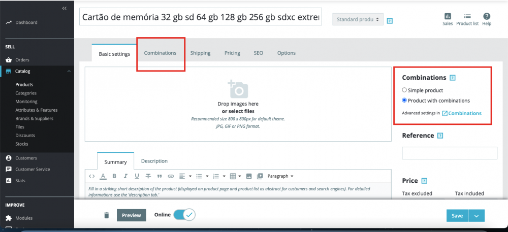

Hi Frederico, many thanks for your post. I tried but couldn't manage properly... could you be so kind to send a print screen? ;)

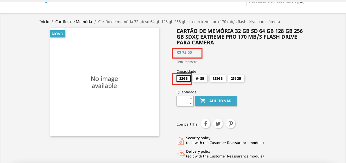

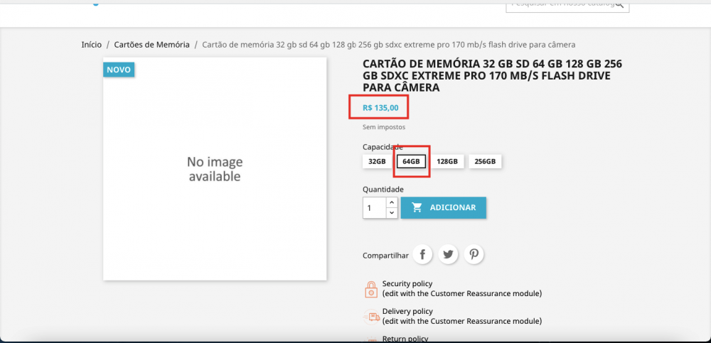

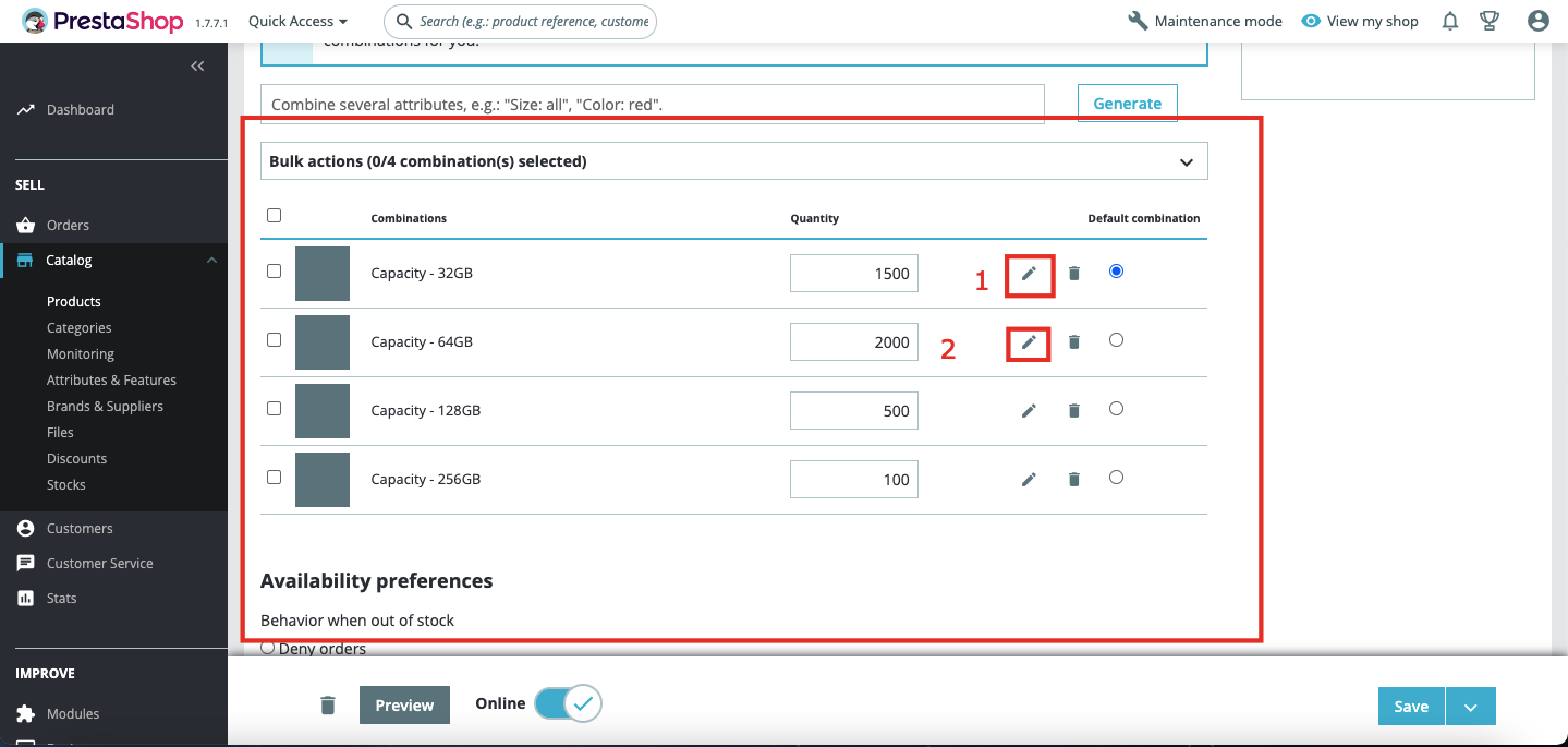

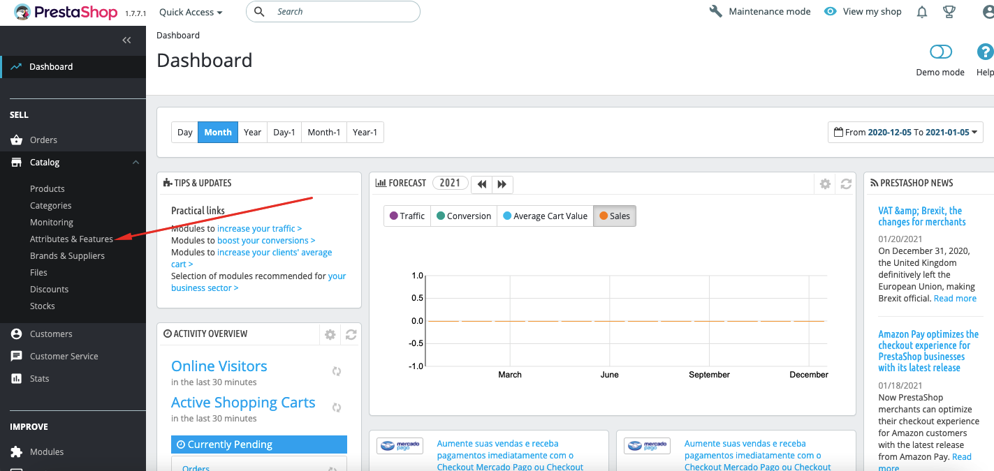

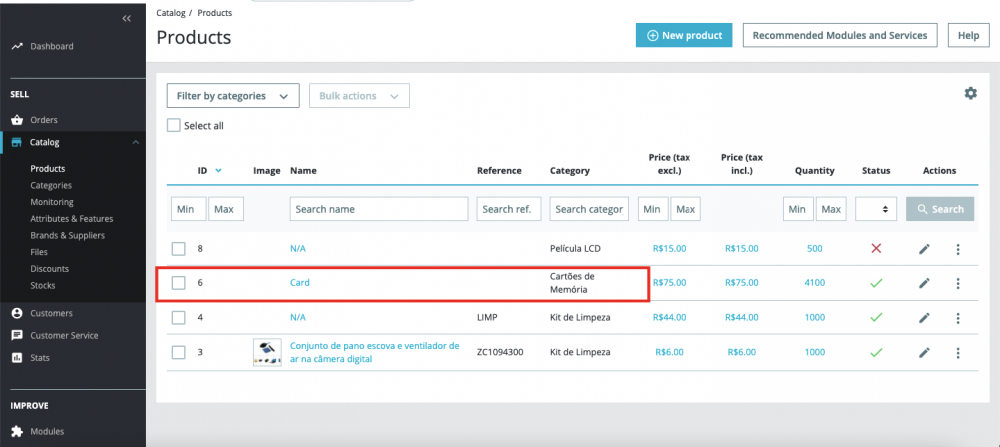

Here is the step-by-step. As you can see in pics 10 and 11, the price increases. The result is presented at pics 12 and 13 how will be at live store.
