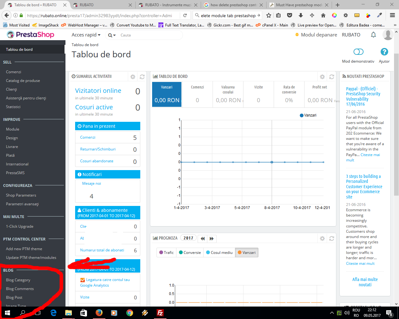

Cosmin T. Posted May 9, 2017 Share Posted May 9, 2017 Hi, guis. I have one problem. After uninstall one module, remain tab in menu Admin. How remove this tab? Link to comment Share on other sites More sharing options...

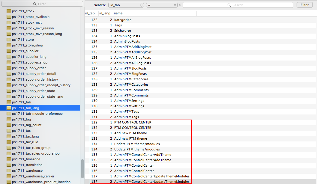

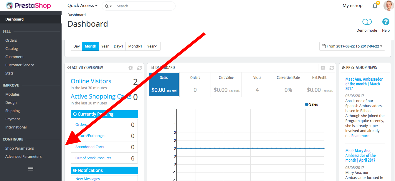

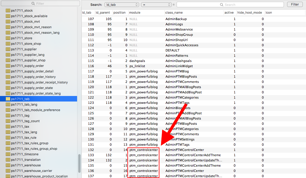

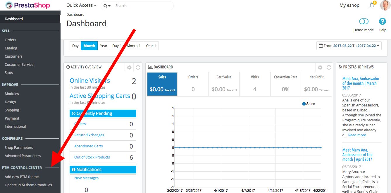

Andrej Stas Posted May 11, 2017 Share Posted May 11, 2017 (edited) Hi! First of all, it's important to say that you have Prestashop 1.7.x, so this solution is also related to this version. Problem: So let's say I have some items in the sidebar that were added by some module. The module has been already uninstalled, but the items remain in the sidebar. (Screenshot "problem.png") Solution #1 (the clean one): Please make sure to archive your DB first. Just in case. Access you DB and locate the table "prefix_tab". View the content of the table. You can find all the items that are in the sidebar. (screenshot "db1.png") As you can see, I can quickly locate all the rows that are related to the module "ptm_controlcenter". Check the "id_tab" column and now remember all the IDs related to this module (in this case it's 132-137) Now access the table "prefix_tab_lang" and remove all rows that have the column ID between 132-137 in the "id_tab". (screenshot "db2.png") Get back to "prefix_tab" table and remove these rows ("id_tab" between 132-137) as well. Done! (screenshot "solved.png") Solution #2 (the quick one): Please make sure to archive your DB first. Just in case. Access you DB and locate the table "prefix_tab". View the content of the table. You can find all the items that are in the sidebar. (screenshot "db1.png") Change the value "1" to "0" in the Active column for all the related rows. Done! (screenshot "solved.png") Edited May 11, 2017 by Andrej Stas (see edit history) 2 Link to comment Share on other sites More sharing options...
