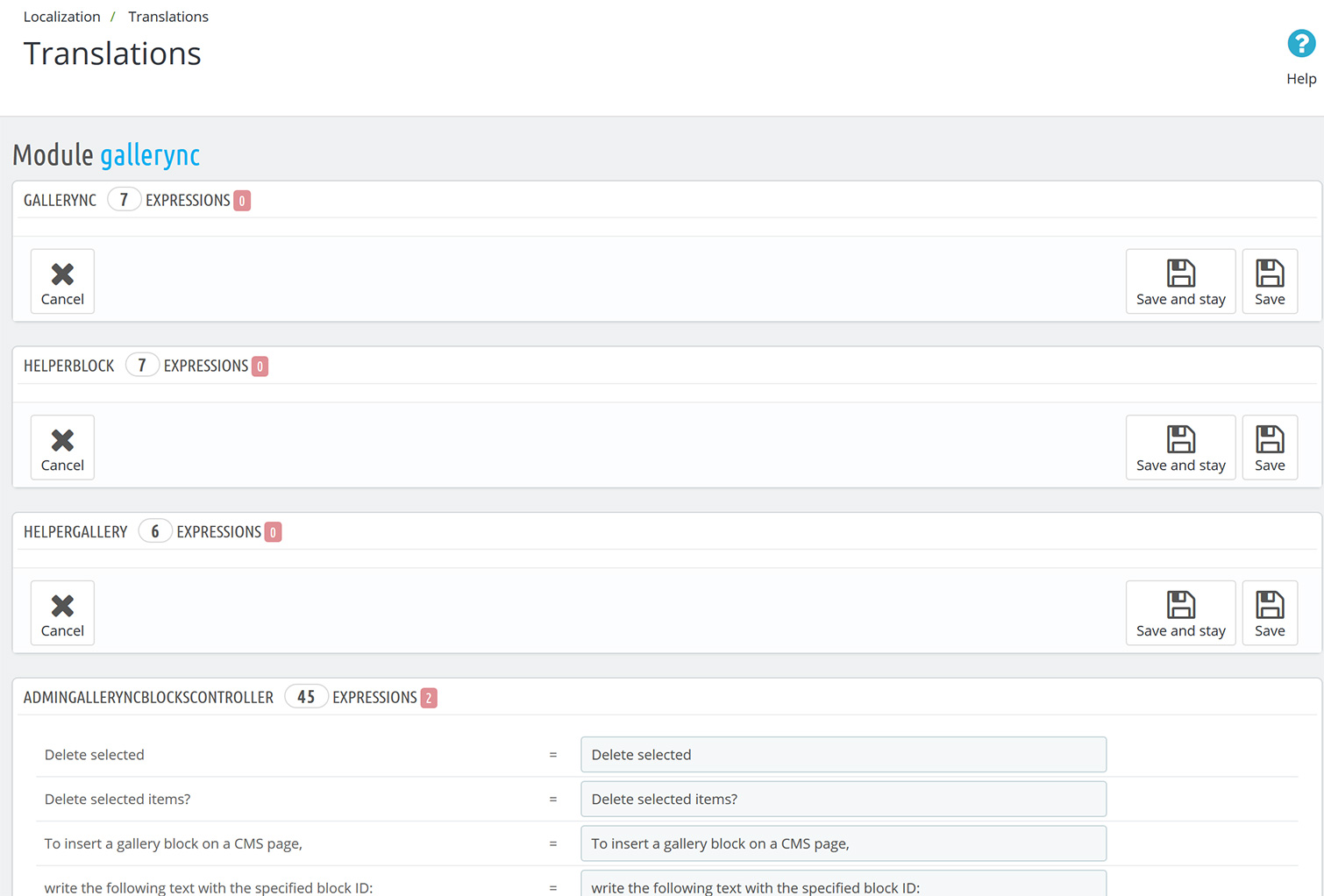

I have no idea why it wouldn't be working. I have no problems translating the admin controllers in my Image/Video Gallery module. Here's what I see:
You could try using $this->module->l instead of $this->l but you shouldn't need to do that.
