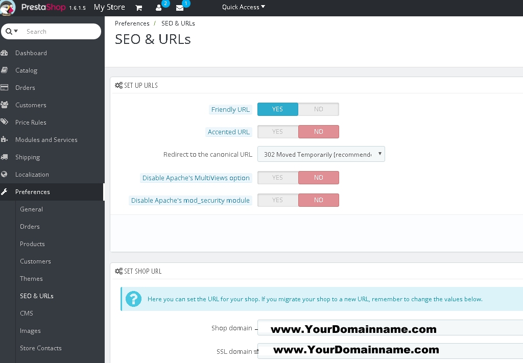

DOCUMENTATION (YOU MAY HAVE ALREADY FOLLOWED)   Moving PrestaShop

    2. Log in to your back office, go to the "Preferences" menu, select the "SEO & URLs" page, and in the "Set shop URL" section change the domain name to your new domain. Do the same for the SSL domain.
      In effect, this will update the "ps_shop_url" SQL table (as well as the "PS_SHOP_DOMAIN" and "PS_SHOP_DOMAIN_SSL" rows in the "ps_configuration" SQL table, for retrocompatibility reasons).
      In effect, this will update the "PS_SHOP_DOMAIN" and "PS_SHOP_DOMAIN_SSL" rows in the "ps_configuration" SQL table.

Hmmm maybe you should try to disable/enable friendly URL to rebuild .htaccess file.
Please also check manually if in ps_shop_url table if there is your new domain.
Have a look at ps_configuration table where name is PS_SHOP_DOMAIN and PS_SHOP_DOMAIN_SSL.
If everything is set correctly, I think it may be problem not with Presta but with domain assignment.
