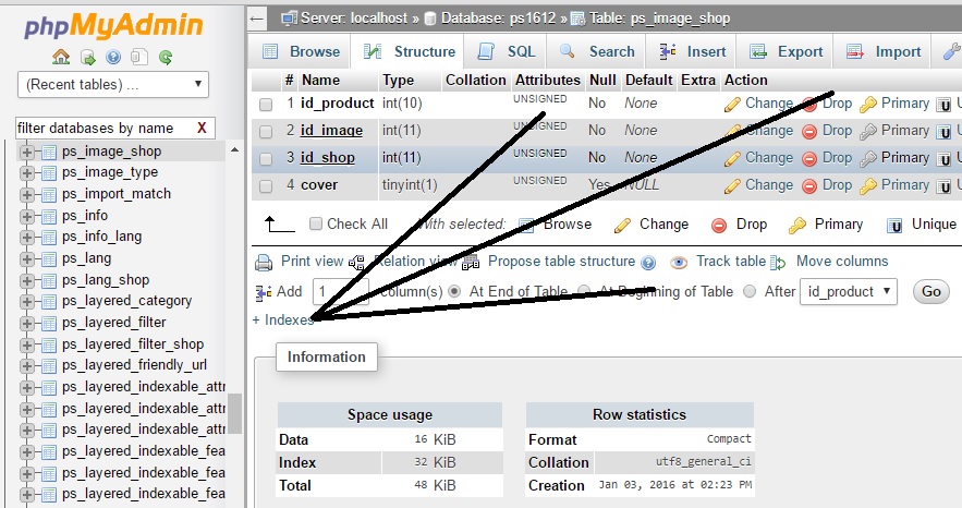

musicmaster Posted July 16, 2016 Share Posted July 16, 2016 One option is that for some reason some table doesn't have the right index. For that reason you could compare the index with that of a fresh installation of the same version. Link to comment Share on other sites More sharing options...
denkbeter Posted July 16, 2016 Author Share Posted July 16, 2016 One option is that for some reason some table doesn't have the right index. For that reason you could compare the index with that of a fresh installation of the same version. What do you mean by index? index.php? Link to comment Share on other sites More sharing options...
musicmaster Posted July 17, 2016 Share Posted July 17, 2016 If you really don't know what database indexes are you have a very big problem, as they are causing your errors. Link to comment Share on other sites More sharing options...
denkbeter Posted July 17, 2016 Author Share Posted July 17, 2016 If you really don't know what database indexes are you have a very big problem, as they are causing your errors. Thank you. I know what database indexes are but never really had to work with them before. I will take a look at it. Link to comment Share on other sites More sharing options...
