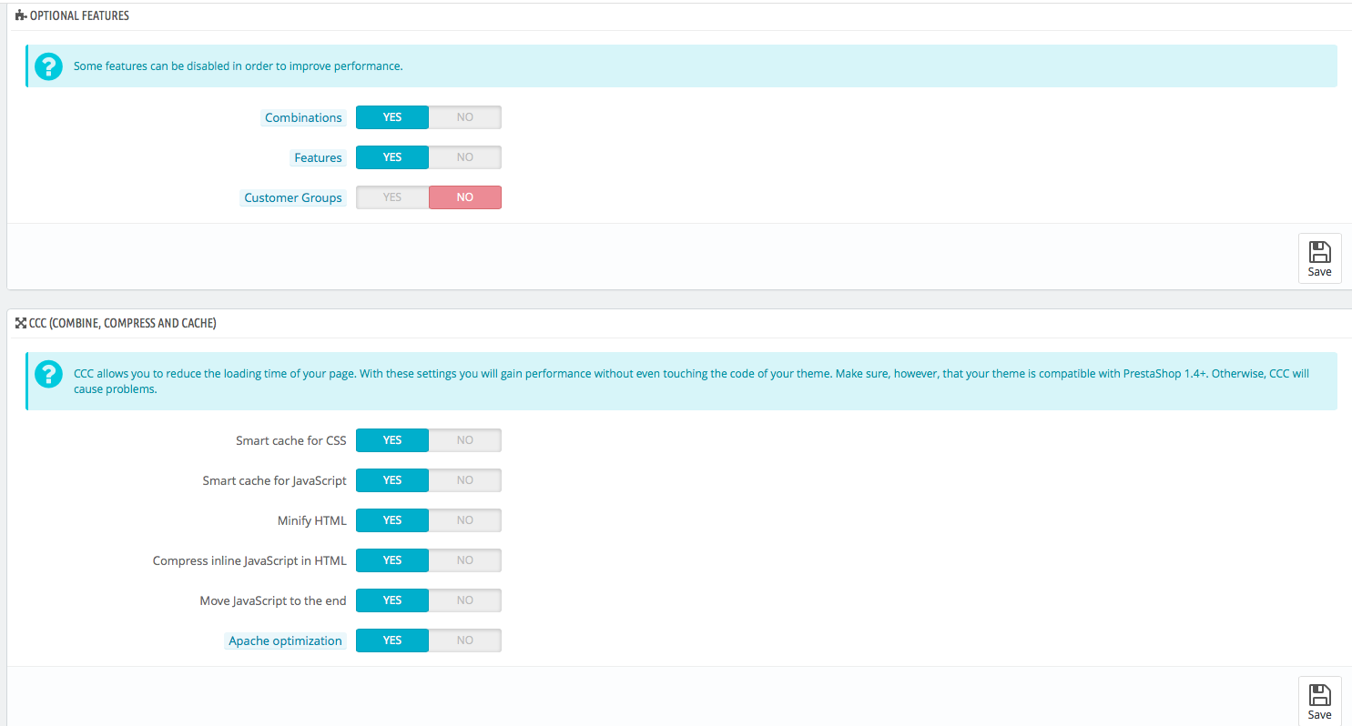

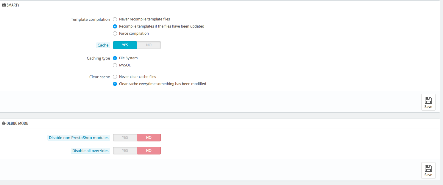

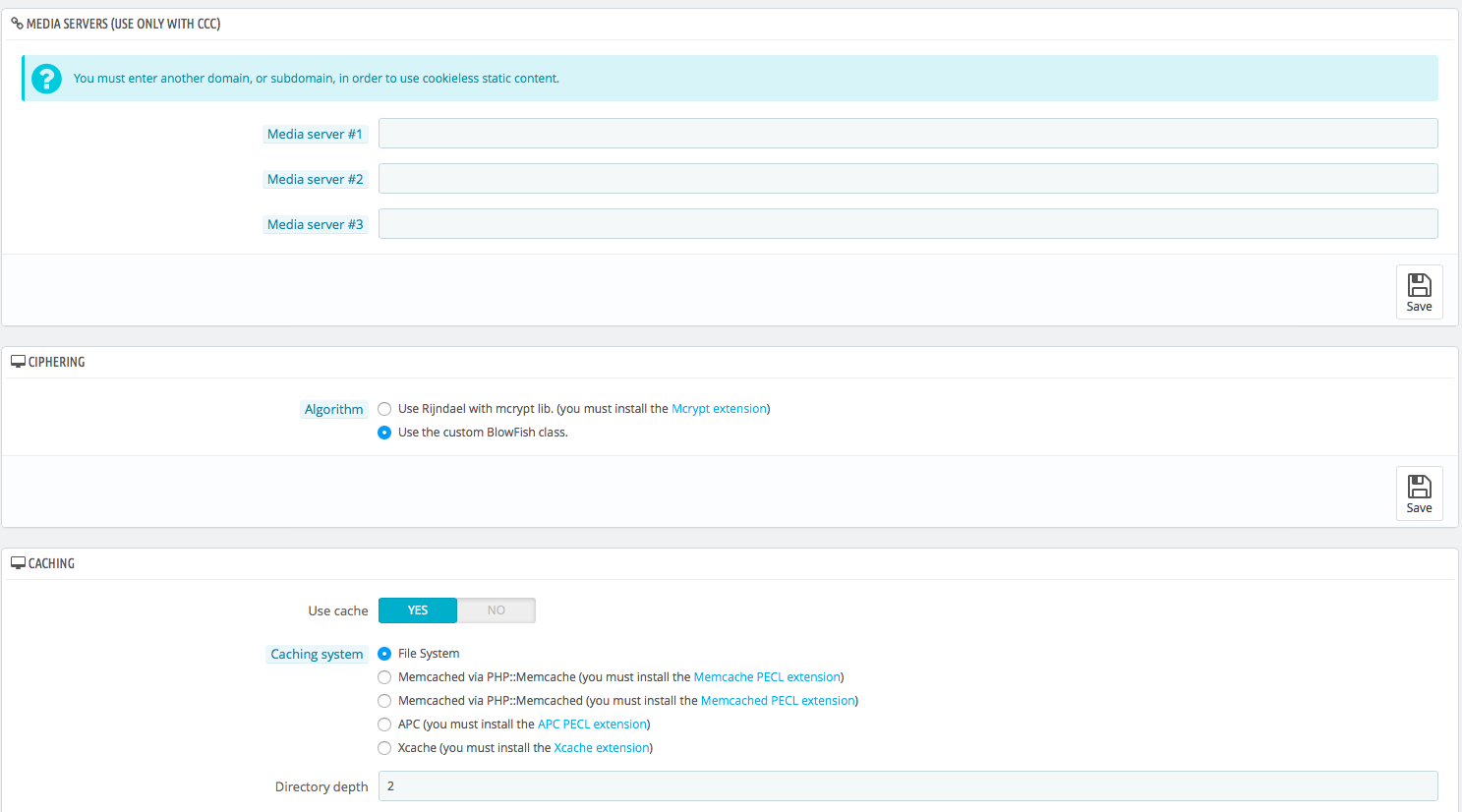

delphan Posted February 20, 2017 Share Posted February 20, 2017 Hi My backoffice 1.6.1.6 is terribly slow. When I try to adjust product pages, I get a timeout, and the “save” button in not clickable (the wheel keeps turning). This is what I did to try to solve it: - performance panel - switched off third party modules - performance panel - switched off combiniations and features - checked the error logs: but no problems - On the hosting side in Cpanel: changed the max_execution_time from 300 to 1000 - activated debug mode, but no problems found But none of that worked. In attachments the print screens of my performance page. Can someone help? Link to comment Share on other sites More sharing options...
PrestaHeroes.com Posted February 20, 2017 Share Posted February 20, 2017 Hi My backoffice 1.6.1.6 is terribly slow. When I try to adjust product pages, I get a timeout, and the “save” button in not clickable (the wheel keeps turning). This is what I did to try to solve it: - performance panel - switched off third party modules - performance panel - switched off combiniations and features - checked the error logs: but no problems - On the hosting side in Cpanel: changed the max_execution_time from 300 to 1000 - activated debug mode, but no problems found But none of that worked. In attachments the print screens of my performance page. Can someone help? most of the issue with product editing was solved I think in 1.6.1.9. It is not really possible to apply those patches too 1.6.1.6 unless you have mad skillz. So please consider an upgrade using best practice methodolgy, i.e. create dev copy run upgrade to see if you are able to upgrade correctly then go from there to a production implementation. Link to comment Share on other sites More sharing options...
