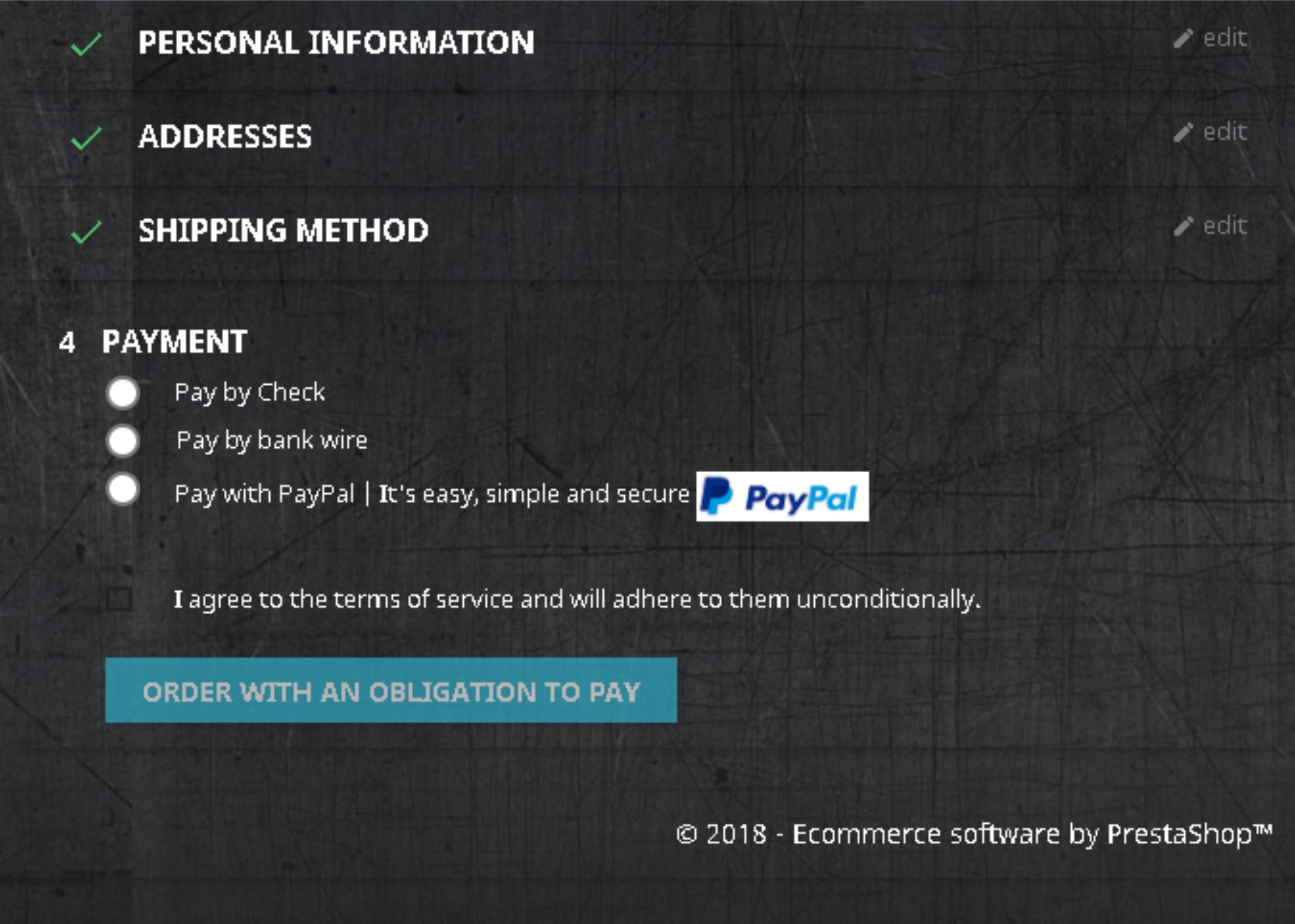

I have a big problem with the checkout page, you cannot see the box to tick for the terms and condiitons, is there an easy way to make it bigger - just like the payment buttons would be ideal, i have lots of abandoned carts as people cannot see they have to click it before it allows them to order.
Is there also a way to spell Cheque correctly for the UK or do we have to stick with the American check, also for the UK it should be bank transfer rather than wire ?
Any help would be gratefully received.
