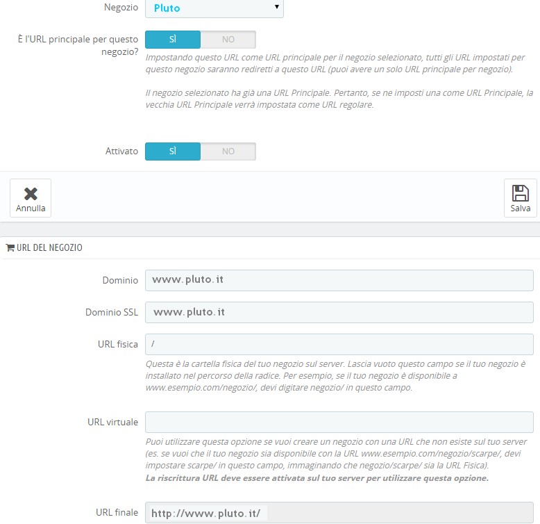

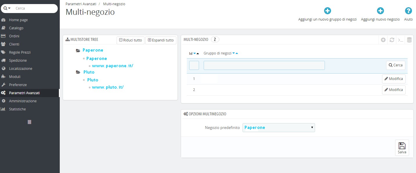

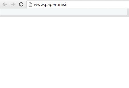

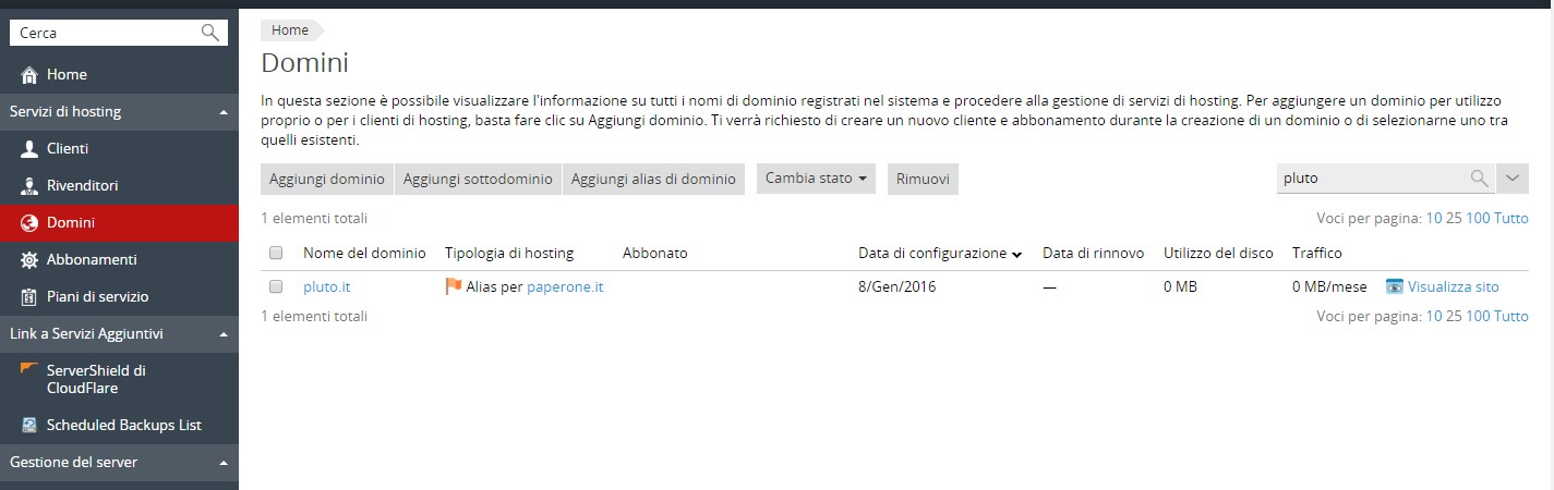

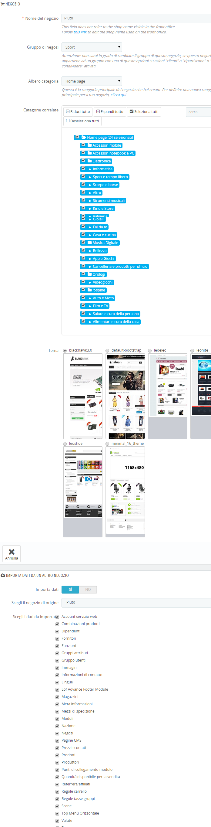

Shop66 Posted January 8, 2016 Author Share Posted January 8, 2016 (edited) I have two shops: 1) paperone.it (Prestashop is installed); 2) pluto.it (without Prestashop). I created an alias in Plesk pluto.it called for the second shop. Then I went in the back office of PrestaShop is I added a shop (Pluto) in Multisore I configured the domain (www.pluto.it) At this point by typing the name www.pluto.it in my browser I should see the configuration of the new shop. Instead I was redirected to www.paperone.it and see the configuration shop1 (www.paperone.it) Why? Edited January 8, 2016 by Shop66 (see edit history) Link to comment Share on other sites More sharing options...
PrestaHeroes.com Posted January 10, 2016 Share Posted January 10, 2016 (edited) define pluto in back office as www.pluto.it, ps has been 'known' to treat www and non-www url as two different url's. many of us have put redirect in our .htaccess to ensure we used with or without www depending on our back office configuration. also I have in the past not been able to alias an .it url to my own shop because it has 2nd registrar, and might not be set up properly, this is why I suggested contacting your hosting company and/or search about configuration of .it ccTLD. I pointed this out in post 6. Edited January 10, 2016 by El Patron (see edit history) Link to comment Share on other sites More sharing options...
