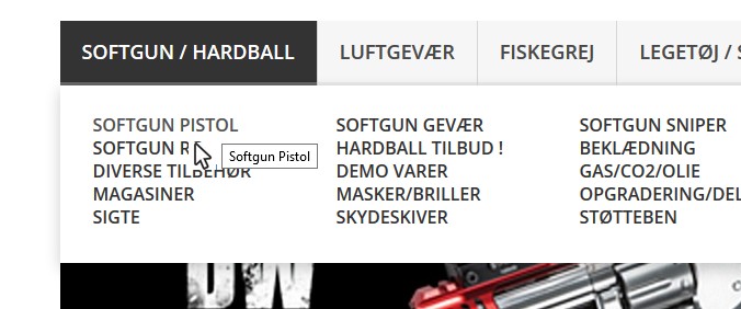

Hi
I have tried to hide the sub categories with the above solution, and they are hidden now, but i would like the sub categories to unfold on 'mouse over' (hover).
Anyone that know at fix for that ?
I use Prestashop 1.6.1.4 default theme wtih sticky menu mod from vekia.
Edited by Bonjovi67 (see edit history)
