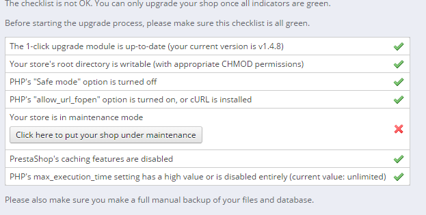

Yan Studio Posted March 18, 2015 Share Posted March 18, 2015 (edited) Hi I have a clean install 1.6.0.14 and in one click upgrade i get an error: PHP's max_execution_time setting has a high value or is disabled entirely (current value: 600 seconds) Any Advice is welcome follow the link to see picture: https://www.dropbox.com/s/2d37mkhw1whmub1/Error.PNG?dl=0 Edited March 18, 2015 by Yan Studio (see edit history) Link to comment Share on other sites More sharing options...

bellini13 Posted March 19, 2015 Share Posted March 19, 2015 Your screen shot from the original post says the current value is unlimited, and it has a green check mark. This means your PHP software is configured to allow a PHP script to run infinitely, which could be a good thing for the upgrade process. So I am confused about 2 things 1) You say you have a clean install of Prestashop v1.6.0.14. Since this is the latest version, why do you even care about the autoupgrade module right now? 2) What exactly is your issue? Link to comment Share on other sites More sharing options...
Yan Studio Posted March 19, 2015 Author Share Posted March 19, 2015 Hello my friend In your first question the picture in the post is wrong the linked is the correct. about upgrade you are correct is clean 1 .6.14 but always i am thinking the future what will happened when the update will come? will be ok? or i will run like crazy to fix things??? but i will say again that the online version reports the same problem and the hosting people told me that this is a bug because they set 120s and still reporting 600 same like my local before the crazy fix that it worked Regards Link to comment Share on other sites More sharing options...
