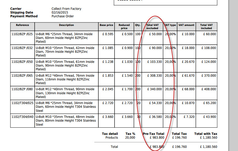

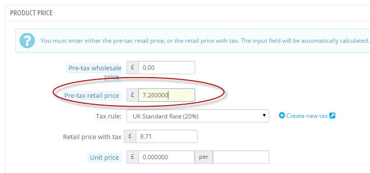

Guest Posted March 9, 2015 Share Posted March 9, 2015 Long discussions on tax for realease 1.6.0.11 recently and I had hoped it would solve the problems, but as far as I can see it still does not "add up" Product details: as you can see the pre-tax value is 7.26 - this is the value we have typed in Now, having used Tuk's brilliant software to get more detail into the invoice you can see The pre-tax is shown as 7.26, but buting 10 off changes that to £72.58. not 72.60 as it should be - it does show £72.60 in the detail totals. This looks so unprofessional. I have tried all the variations of the new tax calculations but cannot get it to be correct And I think I know why. VAT is value ADDED tax and I think prestashop is doing it the other way in some places. So for us base price £7.26 VAT at 20% = 1.452 giving a total of £8.712 rounded to £8.71 - Correct However on the invoice it is taking £7.258 as the base price - where is that coming - well go backwards. £8.71- VAT = £7.258!!!! so to calculate prestashop is going backwards to get the base price No wonder our invoices are never right I am at a loss really as to how to configure this correctly now. We have added issues when there are discounts and large volumes in the mix Here was can see the pre-tax total is over £1 in error I have tried rounding per item, per line, per total, 2DP, 3DP etc. Can anyone tell me what settings can use so that the invoices add up ! Link to comment Share on other sites More sharing options...

Guest Posted March 9, 2015 Share Posted March 9, 2015 Can you send me the Debug template outputs for both invoices? I will try it using your amounts and then we will see. This must not be left unsolved! Hi Thanks for offering to take a look I have attached the details of the largest order, plus the standard Pretashop invoice. This is not to do with your module though, it is general I think. It is there all the time i think, but only really obvious when higher quantity orders and when discounts are applied orderdetailC27613.pdf orderdetail27728A.pdf IN007510 (1).pdf Link to comment Share on other sites More sharing options...

tuk66 Posted March 11, 2015 Share Posted March 11, 2015 Hi Thanks for offering to take a look I have attached the details of the largest order, plus the standard Pretashop invoice. This is not to do with your module though, it is general I think. It is there all the time i think, but only really obvious when higher quantity orders and when discounts are applied It was number of decimals (3) together with the template (m4_invoice_4.tpl). Number of decimals is new feature in v1.6.0.11. I have fixed this template and will improve all other templates in the next release. P.S. I can not attach tpl or zip file. Can you PM your email? Link to comment Share on other sites More sharing options...
