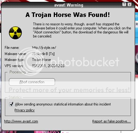

Yumex Posted January 9, 2010 Share Posted January 9, 2010 Hello people!We have had some problems with our shop. People using avasthave seen a trojan error message looking like this:http://i355.photobucket.com/albums/r447/Yumex_photobucket/trojanattack.jpgWe solved the problem with the help from the avast community. Saying it was somehack and false code that entered our site. We cleaned it up with a "fixfiles.php". It came back 3 days later, but I have continued to clean it since.How to make it go away? On top of it, avg sounded the alarm on the website todayas well, calling it a phising warning. How do we get rid of this hack?, is there a solution to clean it. We own a few otherprestashop and only these two: www.ji-style.se, www.ji-style.com has the problem (they are made in the same manner).Thank you for your timeRead my latest post for new developement! Link to comment Share on other sites More sharing options...
Paul C Posted January 9, 2010 Share Posted January 9, 2010 Bottom line is that you need to restore the original files to remove it from the site. I think the chances are high that someone (maybe not you if this is the only site you work on that has the problem) has compromised their FTP account for that site and it's being used to upload the infection. The javascript just redirects I think (so as long as there's nothing nasty on the page you end up on it will be fine). You need to also make sure that the PCs used by anyone who has FTP access to that site don't have a virus that will compromise their FTP account again (you can possiby check access times against when the problem file was modified in your server logs).Change all of the FTP passwords.Note that if you're on shared hosting and any directory in your site has 777 permissions, then chances are high that ANYONE with an account/site on that shared server has the ability to infect files in those directories via FTP.Paul Link to comment Share on other sites More sharing options...
