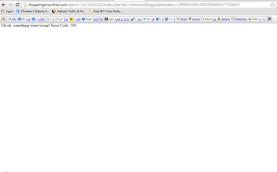

vivianlwy Posted February 7, 2015 Share Posted February 7, 2015 I am having problem upgrade my prestashop from 1.5.6.2 to the latest version. When i click the configure button for the 1-click upgrade module it is show error Uh-oh, something went wrong! Error Code: 500. I had uninstall and install the module 1-click upgrade module. It still show the same error. May i know how to upgrade prestashop to the latest version? Link to comment Share on other sites More sharing options...
Joe Germann Posted February 8, 2015 Author Share Posted February 8, 2015 You might want to look at: http://forums.asp.net/t/2011666.aspx?HELP+Uh+oh+Something+went+wrong+Error+Code+500 Link to comment Share on other sites More sharing options...
