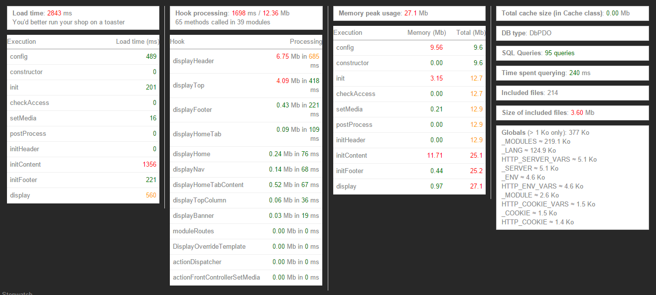

monkeythreads Posted December 11, 2014 Author Share Posted December 11, 2014 (edited) You should enable profiling to see where your site is slow. what is your PS version? I checked shop, you have java bottom, great thing. if 1609 apply this fix. http://www.prestashop.com/forums/topic/349796-performance-hot-fix-please-apply-solved-1609-class-indexphp-has-disappeared/ You should enable profiling to see where your site is slow. I have enables Debug mode, and read about it but don't quite understand exactly what everything means, any help as to a good strategy to speed things up after looking at debug? what is your PS version? I checked shop, you have java bottom, great thing. if 1609 apply this fix. I'm running 1.609 and yes i uploaded the new Auto-Uploadfile for the fix but it didn't really help much. Edited December 11, 2014 by monkeythreads (see edit history) Link to comment Share on other sites More sharing options...
JPresta.com Posted December 11, 2014 Share Posted December 11, 2014 You should enable profiling to see where your site is slow. I have enables Debug mode, and read about it but don't quite understand exactly what everything means, any help as to a good strategy to speed things up after looking at debug? Show us the stats at the bottom of the page, we will tell you if something is wrong. Link to comment Share on other sites More sharing options...
monkeythreads Posted December 11, 2014 Author Share Posted December 11, 2014 Show us the stats at the bottom of the page, we will tell you if something is wrong. forgot to add before.. i've attached the stats on the previous comment. thanks for taking a look Link to comment Share on other sites More sharing options...
JPresta.com Posted December 11, 2014 Share Posted December 11, 2014 Hmm, I don't see any weird stats, looks "normal". Maybe you could try to install a PHP code cache (APC or something). Or an HTML cache. Link to comment Share on other sites More sharing options...
