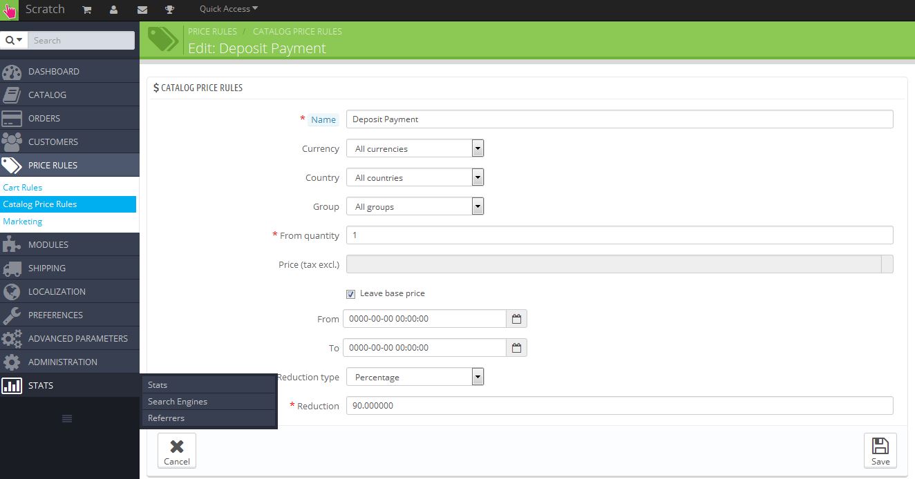

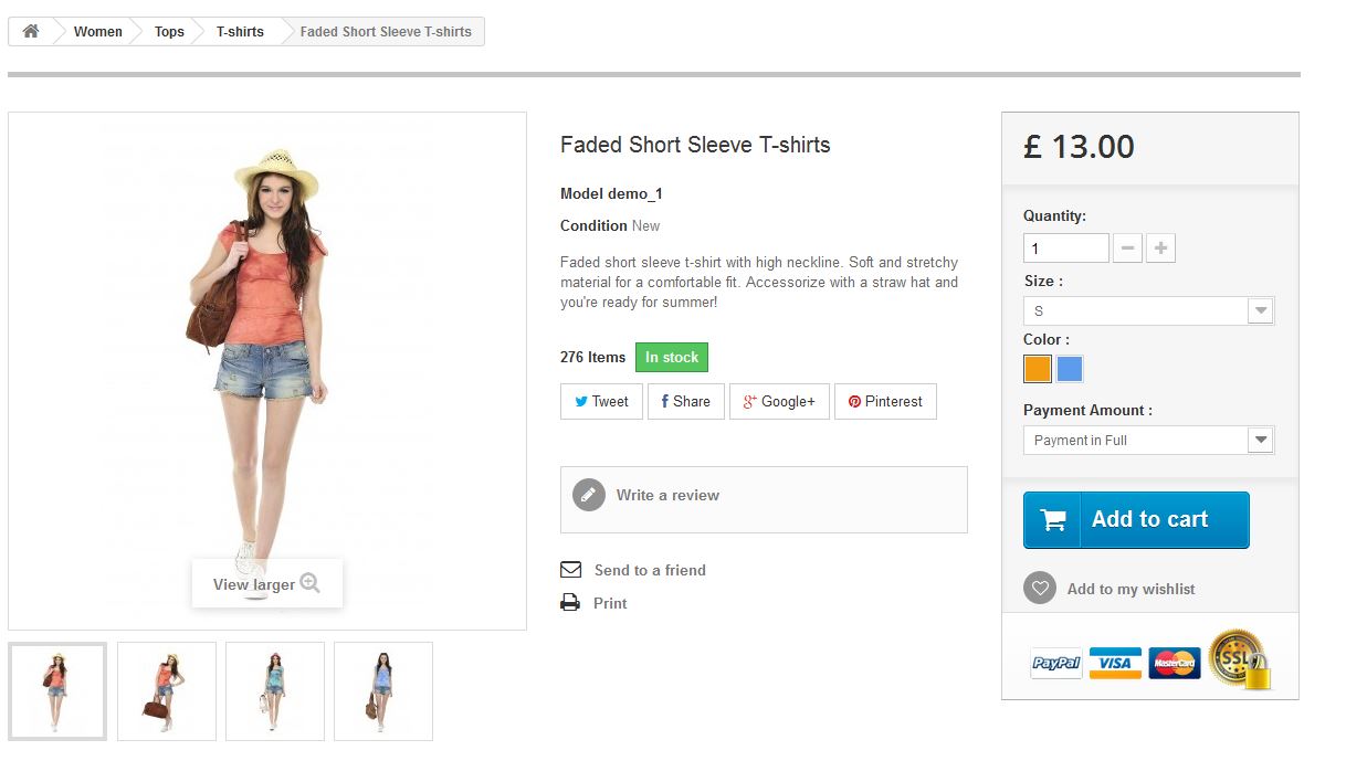

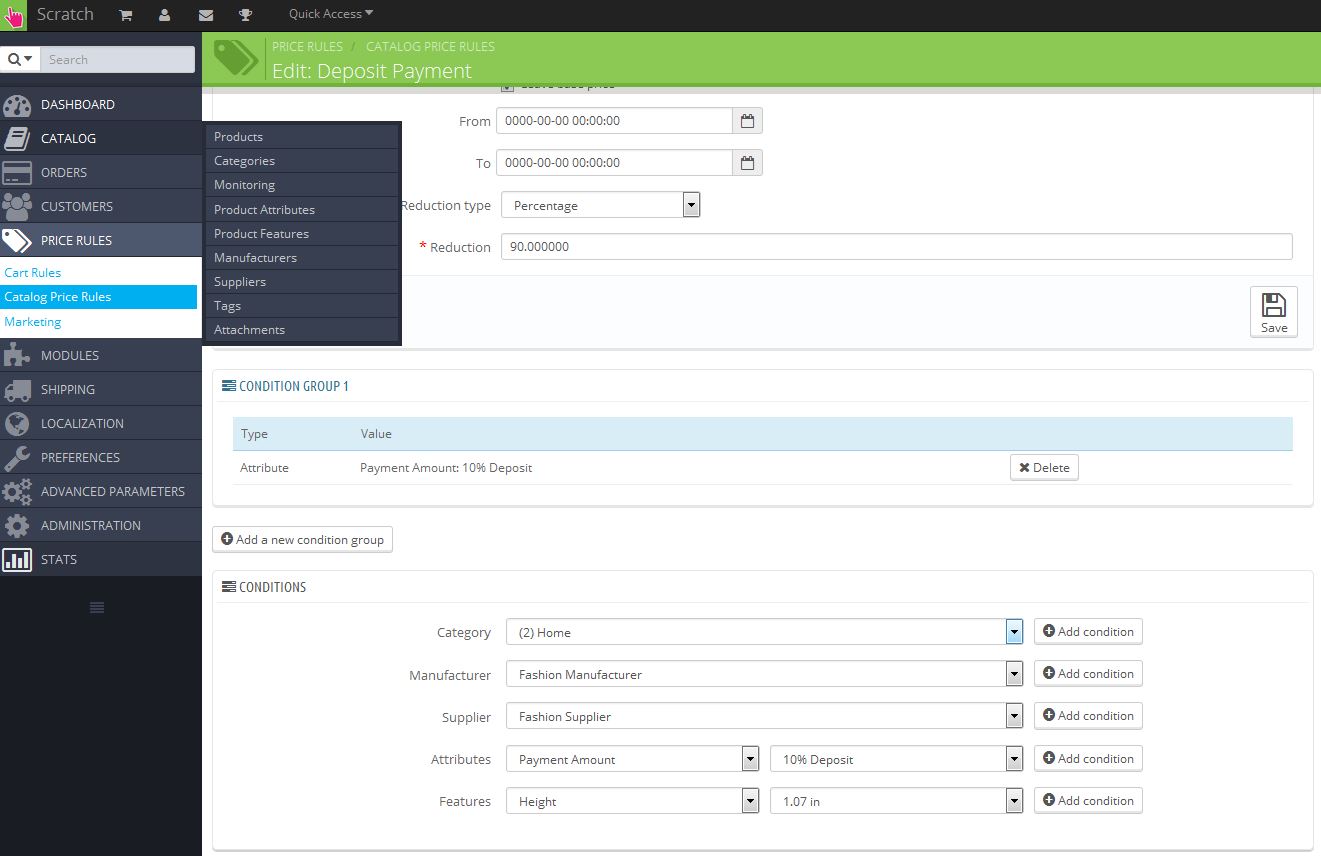

prestatent Posted November 13, 2014 Author Share Posted November 13, 2014 Hi Programming part is not complete at this point, however below is a partial solution that may help you get going with no programming. This solution does not create any vouchers but does allow you to take a partial payment. 1. Add new Catalog->Product Attributes. Call it "Payment Amount"2. Add 2 values to this new attribute. Call one "Full Payment" and the other "10% Discount".3. Add new Price Rules->Catalog Price Rules. Set the following values :- Name = 10% Deposit Payment- Reduction Type = Percentage- Reduction = 90Add a new condition group. Select "Payment Amount" attribute and "10% Deposit" value. Click on "Add Condition" button.See attached images.4. Add the attribute to a product combination. For example:- if you have a t-shirt, size = small, colour = orange, you would add the "Full Payment" attribute value to this combination.So, what you will end up with is that you have two products almost exactly the same with the only difference being the Payment Amount, eg:- T-shirt, Colour = Orange, Size = Small, Payment Amount = Full PaymentAND- T-shirt, Colour = Orange, Size = Small, Payment Amount = 10% DepositSee images for examples.While this is not a perfect solution and does not create any vouchers, it does not involve any programming solution.The overhead is with having to create two combinations for each product, one with full payment and one with 10% deposit. 2 Link to comment Share on other sites More sharing options...
