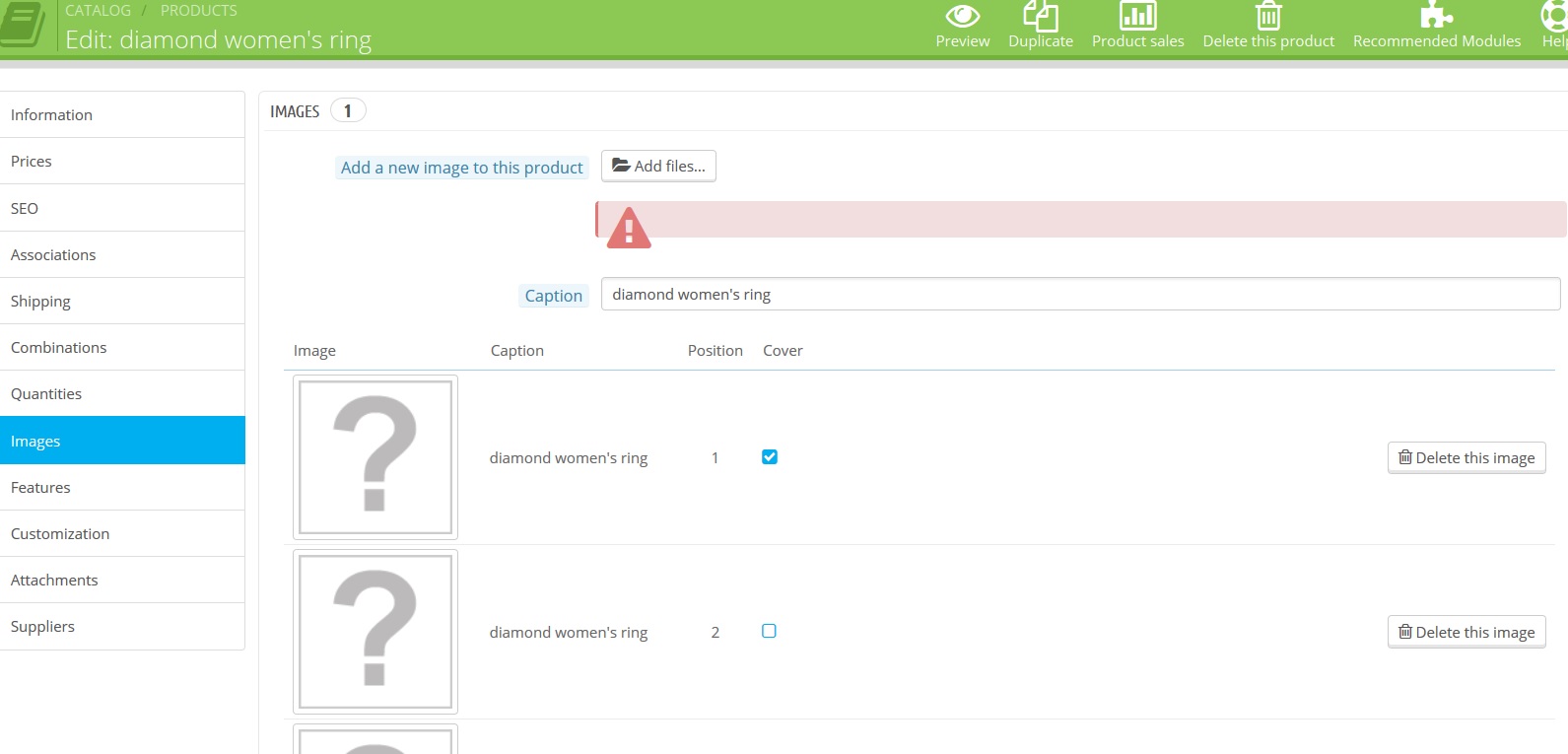

roma123 Posted October 12, 2014 Share Posted October 12, 2014 Hey Guys. I have seem to have run into a big problem with my prestashop 1.6 shop I am developing for a client. For some reason when I try to upload PRODUCT images that are over 72dpi ( e.g 180 dpi or 300 dpi) I receive a RED error box but its empty and then gives me one kind of empty image with a "?" , check the attached image. Also, sometimes it would give me the "memory limit" message but I have already changed the server limit to 128MB. I have attached a sample of the image that I am using. (see if you can upload it or use them in original format) Guys please help me out with this, it is imperative that I can upload the hi-res photo's as my client has thousands of these and wants to upload them ! Thanks. Link to comment Share on other sites More sharing options...

PrestaHeroes USA Posted October 12, 2014 Share Posted October 12, 2014 good two birds, one stone start by turning on error reporting and reproduce issue to see if you get error reported. http://www.prestashop.com/forums/topic/224525-how-to-turn-on-error-reporting-for-debug-information/ for understanding of your runtime phpinfo, use this free module, it is 'very' useful. http://www.prestashop.com/forums/topic/278164-free-module-display-php-environment-phpinfo-back-office/ Link to comment Share on other sites More sharing options...
farior Posted October 16, 2014 Share Posted October 16, 2014 My solution: I increased my PHP memory limit through the php.ini at the PrestaShop folder by adding this row: memory_limit = "1000M" Link to comment Share on other sites More sharing options...
