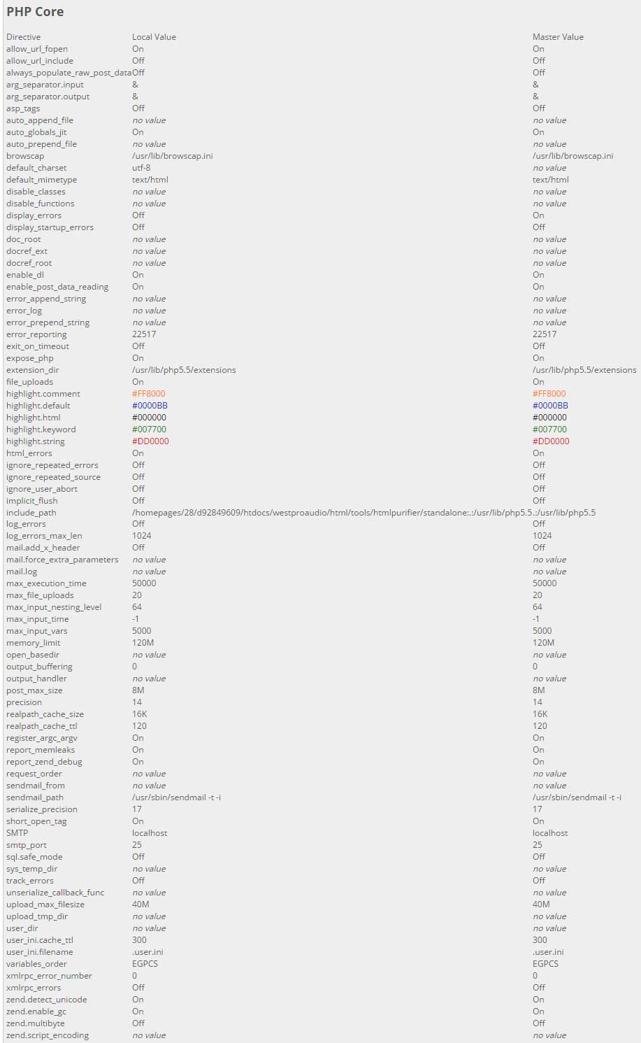

westproaudio Posted October 8, 2014 Share Posted October 8, 2014 (edited) I'm setting up a new site running on 1.6 and I've come across a couple issues that I can't figure out. 1. When I turn on "Friendly URL" everything seems to work EXCEPT 2 links. the Sign Up link on the main page and in the site map. my-account / authentication links in those areas don't work. It just seems to send me back to the home page. All the other links on the site work when Friendly URL is turned on. 2. Configuration Information under advanced parameters throws an error 500. I think I've been able to load the page 4 times. Every other time it seems like it just times out and never loads at all. 3. I can't seem to upload an image larger than 1500px in length or width. Doesn't seem to matter based on file size. As long as its 1500px or below it uploads. If I try to upload anything larger I get a red undefined notification popup. If I refresh the page I see the image upload as a grey question mark. If I click delete I get a green undefined notification popup and the I refresh and the image is deleted. Other than that I haven't seemed to run into any other issues. Everything seems to run smoothly. :-) I've attached a screenshot php info config in hopes that someone has any idea how to fix these 3 issues... Any help would be greatly appreciated. Edited October 8, 2014 by westproaudio (see edit history) Link to comment Share on other sites More sharing options...
Dh42 Posted October 8, 2014 Share Posted October 8, 2014 Try turning off automatically redirect to canonical url in the seo and urls tab and also turn on disable apache multi-views. As for the image upload I am thinking it could be one of 3 things. Either your server times out with that large of an image, prestashop does not support an image of that size, or there is something wrong with the original formatting tha is removed when you reduce the image size. As for the configuration page, I am thinking that your server is timing out. Link to comment Share on other sites More sharing options...
westproaudio Posted October 8, 2014 Author Share Posted October 8, 2014 I set the redirect to cononical url to "no redirection". Tried disable apache's multiviews on and off and It still just goes back to the home page. I feel like since its JUST those links it has to be specific to something about them? Everything else seems fine. I could understand time out due to image file size but not image resolution? What would help fix any time out issues? Anything in the php settings? I looked at sites that recommended settings prestashop and php and my settings seemed to be on par if not higher when they were default from my hosting. Link to comment Share on other sites More sharing options...

PrestaHeroes.com Posted October 8, 2014 Share Posted October 8, 2014 don't bump...so I don't have to say don't bump why not post your front office url for prestanerds to look at. also, 500 error means nothing, turn on error reporting so you have actual error. always do this or search for 500 to find out. http://www.prestashop.com/forums/topic/224525-how-to-turn-on-error-reporting-for-debug-information/ tip: post one topic per question, many won't answer one if they don't know them all. Link to comment Share on other sites More sharing options...

westproaudio Posted October 9, 2014 Author Share Posted October 9, 2014 I've enabled error reporting and I don't get any other information? It still just redirects to home page when clicking on sign-in. Clicking on Configuration Information also still just goes to an error 500? Is there a log somewhere I should be looking at? Link to comment Share on other sites More sharing options...
