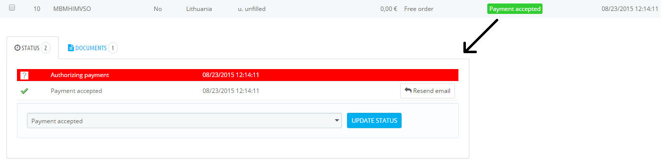

Esnyper Posted August 23, 2015 Author Share Posted August 23, 2015 (edited) Hello, sorry for the long time of silence. I am using hookActionObjectOrderHistoryAddAfter and almost everything working fine, except Order current_status. It remains for last order state. Edited August 23, 2015 by Esnyper (see edit history) Link to comment Share on other sites More sharing options...
