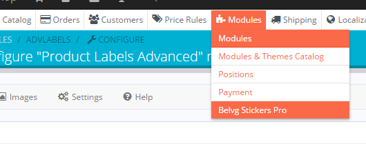

Do you know where to remove the additional links also added in the BO
One is  "Modules/Belvg Stickers Pro"  clickable redirects to "nothing" since i deleted the module
Also one when editing products in the left menu below "adv storage locations"

Hi again, nutxlago.
Module is removed, I'm running dev mode true, btw all this is done on a "local" copy, not the live store.
I know link's like these in Vbulletin are read/added via XML files.
However, I haven't located these 2 yet.  Screenshots below
I have cleaned the DB and file struckture of traces from the module but the links remain.

Because it is surely related to the above overrides. Do you have tried to delete /cache/class_index.php? Do not panic, it is recreated by PS itself if it is not there.
If you encounter problems after that, you can replace autoload.php with the new version linked here at point 1 (Slow PS performance) http://www.prestashop.com/forums/topic/351806-sticky-1609-solved-bugs/.
