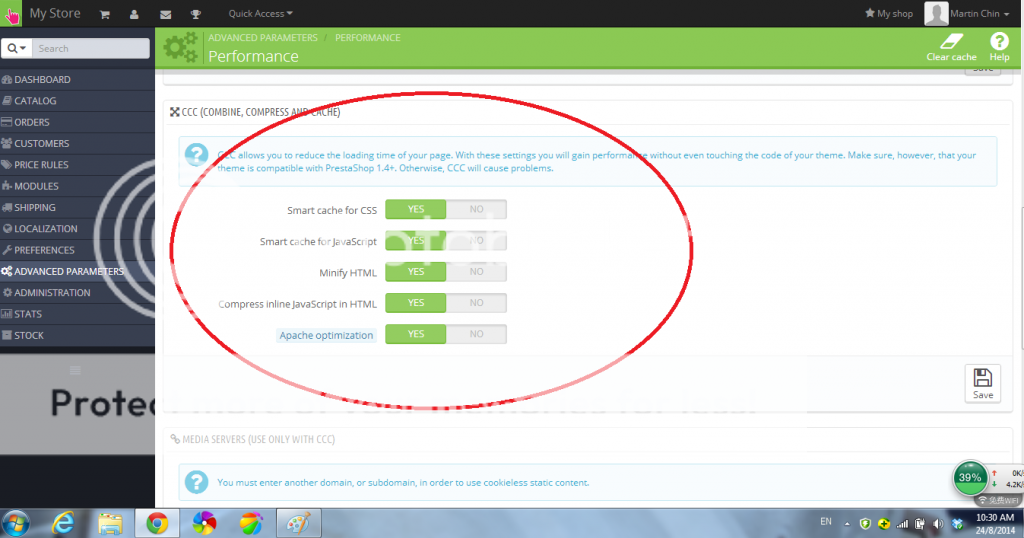

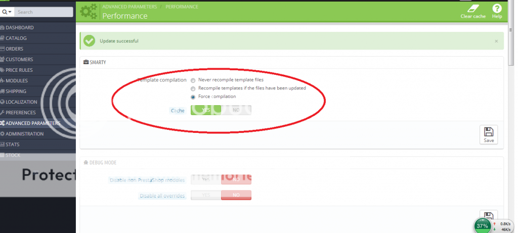

martincvk Posted August 24, 2014 Share Posted August 24, 2014 Dear All, I think I'm facing the same issues with Flavex, I am a new project owner and start to learn how to set up the website. now the website consider 90% done but I felt that the loading time of webpage will very load, I still looking the solution on it. Talking about the parameters performance, I have the setting attached, can help me to take a look is it correct ?? Link to comment Share on other sites More sharing options...
PrestaHeroes.com Posted August 24, 2014 Share Posted August 24, 2014 Dear All, I think I'm facing the same issues with Flavex, I am a new project owner and start to learn how to set up the website. now the website consider 90% done but I felt that the loading time of webpage will very load, I still looking the solution on it. Talking about the parameters performance, I have the setting attached, can help me to take a look is it correct ?? the second image (smarty compile) should be set to one of the first two options. 1 Link to comment Share on other sites More sharing options...
martincvk Posted August 24, 2014 Share Posted August 24, 2014 Thanks for your help! I set the second options. ONE MORE QUESTION! What about this set up? should it been off or on? please advice with thanks!! Link to comment Share on other sites More sharing options...
