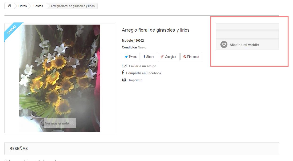

theduckface Posted July 8, 2014 Share Posted July 8, 2014 Hello, after installing the PS 1.6.0.8 and changing the products I am not able to see the Add to Cart button the only thing is add to my wishlist, but that is not functioning. Do you have any ideas, where I should look? Link to comment Share on other sites More sharing options...
PSfever.com Posted July 8, 2014 Share Posted July 8, 2014 Hi, there are many factors that could have disabled the Add to Cart button 1) Is your store in Catalogue mode? 2) Are those products on stock (in case that you enable ordering only for products with quantity >0)? 3) Do these products have combinations that are not in stack? Those are just some option from the top of my head. What theme do you use? 1 Link to comment Share on other sites More sharing options...
theduckface Posted July 8, 2014 Author Share Posted July 8, 2014 (edited) I use the default-bootstrap version 1.0theme which comes with the shop installation. I´ve made a fresh install. it is a flowershop Catalogue mode no stock activated. Edited July 8, 2014 by theduckface (see edit history) Link to comment Share on other sites More sharing options...
theduckface Posted July 8, 2014 Author Share Posted July 8, 2014 all modules are authorized in all customergroups Link to comment Share on other sites More sharing options...
PrestaHeroes USA Posted July 8, 2014 Share Posted July 8, 2014 back office-->preferences-->products-->set catalog mode to 'no' (as stated by psfever earlier) when in catalog mode, shopping/prices/carts etc. are not allowed. 2 Link to comment Share on other sites More sharing options...

theduckface Posted July 8, 2014 Author Share Posted July 8, 2014 Thanks El Patron that was it! 1 Link to comment Share on other sites More sharing options...
