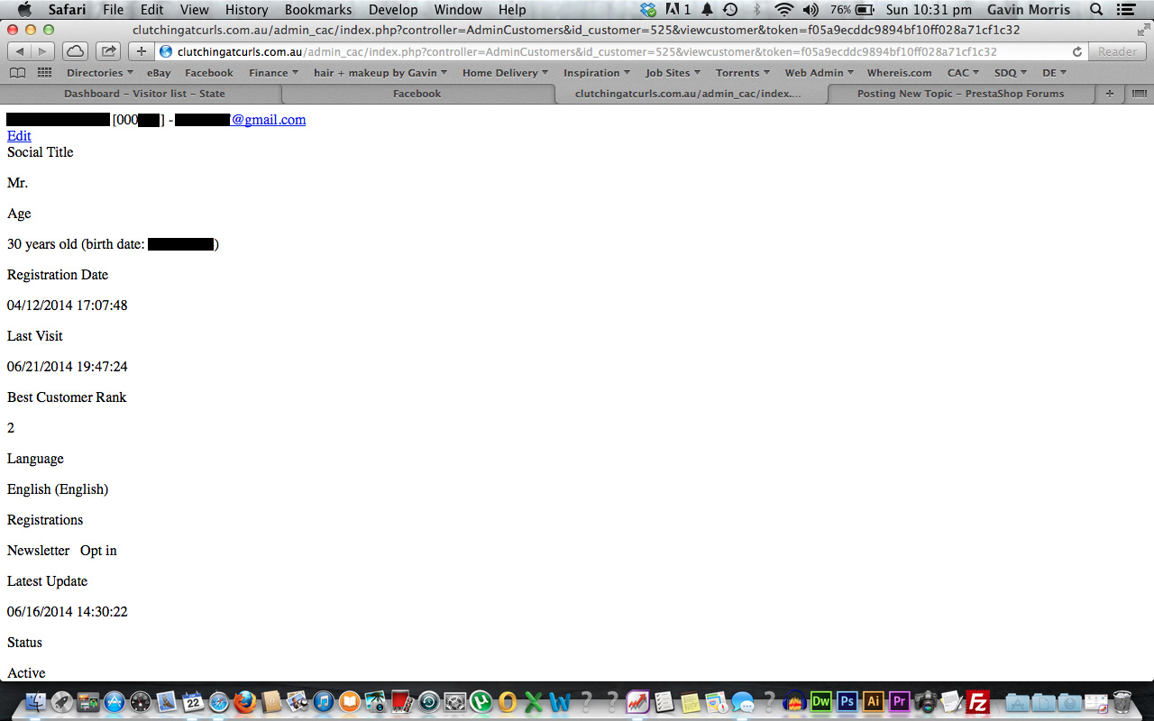

gavz Posted June 22, 2014 Share Posted June 22, 2014 When selecting a customer, the detail page has not formatted correctly & returns a fatal error. Link to comment Share on other sites More sharing options...

gavz Posted June 28, 2014 Author Share Posted June 28, 2014 "console" for example, red error below: There are no errors in the console. Screenshot here https://clutchingatcurls.com.au/ScreenShot-console.png Link to comment Share on other sites More sharing options...
vekia Posted June 28, 2014 Share Posted June 28, 2014 strange press ctrl+U you will see page source can you attach <header> section code, please? Link to comment Share on other sites More sharing options...
gavz Posted July 3, 2014 Author Share Posted July 3, 2014 strange press ctrl+U you will see page source can you attach <header> section code, please? There doesn't seem to be a header section? https://clutchingatcurls.com.au/ScreenShot-CustomerDetail.png Link to comment Share on other sites More sharing options...

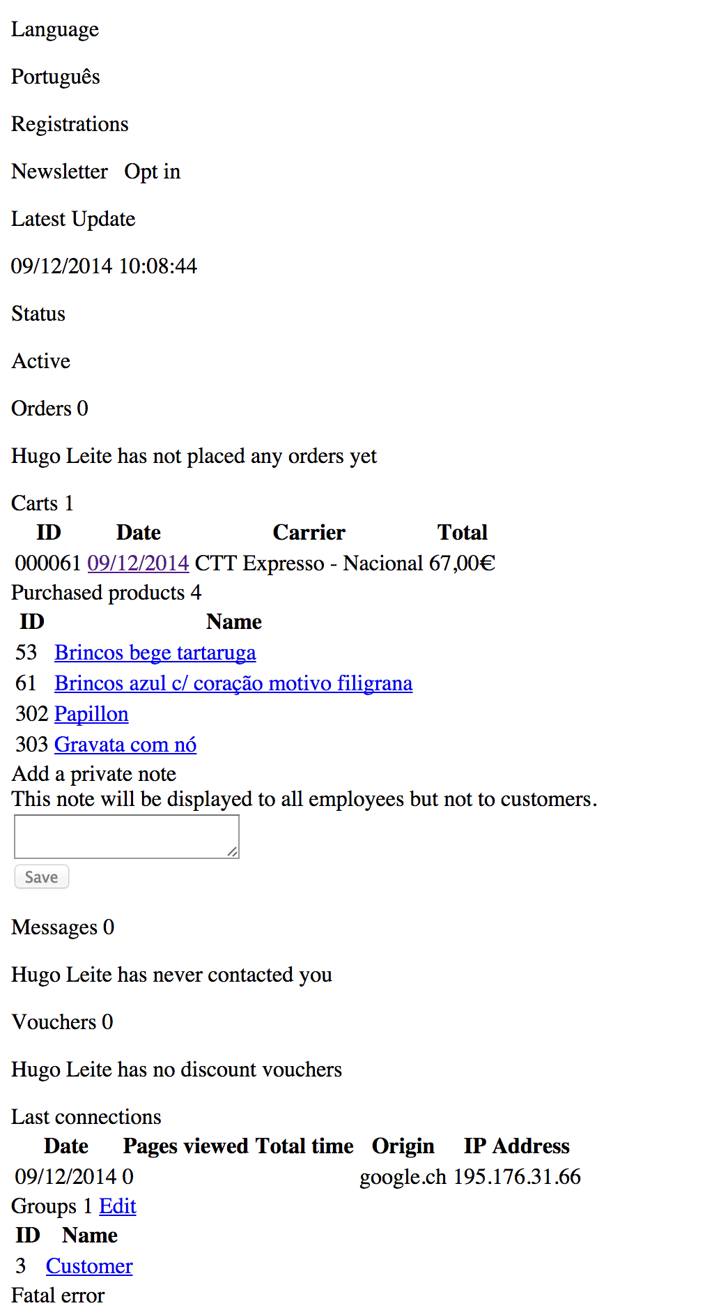

soupn Posted September 12, 2014 Share Posted September 12, 2014 Hello, I have the same problem. Everything was working fine, and today I´ve made and modules update and costumer details started to give fatal error. Theres another users with same problem: http://forge.prestashop.com/browse/PSCSX-2747 Link to comment Share on other sites More sharing options...

soupn Posted September 12, 2014 Share Posted September 12, 2014 I turned off Wishlist module and now I can edit customer tab, so it works. I'm just wonder what's wrong is with Wishlist module. yes, when Wishlist module is turned off, the customer details are back to normal... 2 Link to comment Share on other sites More sharing options...
gavz Posted September 13, 2014 Author Share Posted September 13, 2014 yes, when Wishlist module is turned off, the customer details are back to normal... Turning off WishList module worked for me as well. A much easier option compared to the the previous advise I was given on the Forge site, which involved upgrading my entire store again! Thank you Link to comment Share on other sites More sharing options...
slett Posted September 13, 2014 Share Posted September 13, 2014 Turning off WishList module worked for me as well. A much easier option compared to the the previous advise I was given on the Forge site, which involved upgrading my entire store again! Thank you This bug is due to a recent Wishlist module upgrade. Link to comment Share on other sites More sharing options...
slett Posted September 14, 2014 Share Posted September 14, 2014 (edited) Hello, an upgrade (wishlist 1.1.3) resolved this problem yet Edited September 14, 2014 by slett (see edit history) Link to comment Share on other sites More sharing options...
