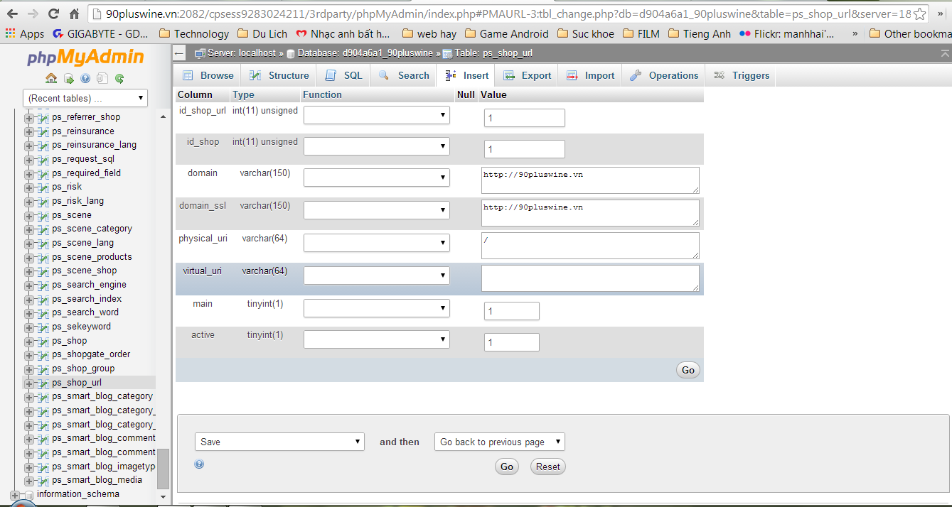

luthanhphu Posted June 8, 2014 Author Share Posted June 8, 2014 (edited) what is the data in this table? Hi El Patron, Please attached file. Thank for your promptly support . By the way, I don't mind if you could log in to my host to inspect. Also remind you that SEO&URLs asked me to change to www.90pluswine.vn while the good config was http://90pluswine.vn. Edited June 8, 2014 by luthanhphu (see edit history) 1 Link to comment Share on other sites More sharing options...
luthanhphu Posted June 8, 2014 Author Share Posted June 8, 2014 (edited) Edited June 8, 2014 by luthanhphu (see edit history) Link to comment Share on other sites More sharing options...
El Patron Posted June 8, 2014 Share Posted June 8, 2014 remove the http then you should be ok. The shop_url domain and ssl domain should only contain the domain name not the http, i.e. mydomainname.com or www.mydomainname.com Link to comment Share on other sites More sharing options...

luthanhphu Posted June 8, 2014 Author Share Posted June 8, 2014 (edited) remove the http then you should be ok. The shop_url domain and ssl domain should only contain the domain name not the http, i.e. mydomainname.com or www.mydomainname.com Hi El Patron, Actually, I've changed or removed several times but the situation is still the same. The origin was 90pluswine.vn as you said, when it came to error , I tried to change to some possibly urls. Edited June 8, 2014 by luthanhphu (see edit history) Link to comment Share on other sites More sharing options...
