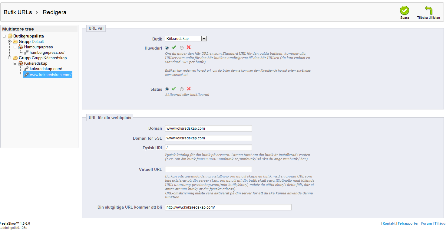

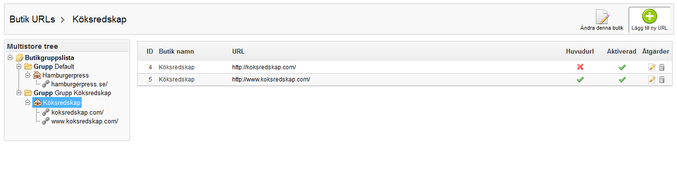

Emilll Posted May 22, 2014 Share Posted May 22, 2014 Hi. Today we have a store called hamburgerpress.se. This one is hosted on a webbhotel called one.com. We bought the domain and everything from there. Recently we got the idea to start a second project, so we bought the domain www.koksredskap.com from the same supplier but without a webbhotel since we wanted to use the multishop feature. I read all the information about how to do this, and started to set up the multistore fearture. I have done this according to the attached pictures CapturePrestashop and CapturePrestashop2. First of all, is this correct? Because I have tried to "point" the domain name to my webbhotel, but when i search on www.koksredskap.com I land on my old page www.hamburgerpress.se but with the new adress. Link to comment Share on other sites More sharing options...
