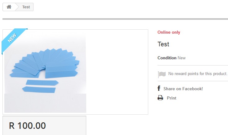

If you look at the images you will see that
1. The height and width of the box holding the image are not correct.

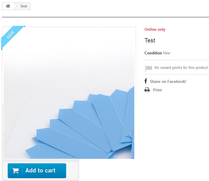

2. When I mouse over the image for the zoom, image overlaps box dimensions.
3. When I move the crosshair around the zoomed image, it only navigates a small part of the image.

Okay I did play around there but there has not been any change. It states the default width and height is 458.
Any other line of code I should be looking for?
Here is what I'm talking about:
	//set jqZoom parameters if needed
	if (typeof(jqZoomEnabled) != 'undefined' && jqZoomEnabled)
		$('.jqzoom').jqzoom({
			zoomType: 'innerzoom', //innerzoom/standard/reverse/drag
			zoomWidth: 458, //zooming div default width(default width value is 200)
			zoomHeight: 458, //zooming div default width(default height value is 200)
			xOffset: 21, //zooming div default offset(default offset value is 10)
			yOffset: 0,
			title: false
can you change the innerzoom by one of the options given there!
zoomType: 'innerzoom', //innerzoom/standard/reverse/drag  ( now it is innerzoom, that is why you have the zoom inside the picture, try one by one, standard, or reverse or drag) but i think the standard will do... try and let me know the result
Thanks for getting back to me :)
standard/reverse/drag all seem to work fine. It's just the innerzoom.
Also when I change zoomWidth to 200 and zoomHeight to 200 it does not seem to make any change at all.
Sometimes when I make a change to the code for product.js - the changes take a affect once but then when I relode the page it goes back to what it was originally. The only change that seems to stick it the zoomType?
