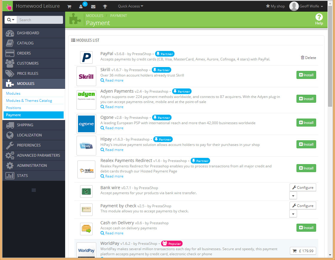

Geoff1066 Posted April 30, 2014 Share Posted April 30, 2014 Hi I have downloaded the free paypal europe module from here... http://addons.prestashop.com/en/payments-gateways-prestashop-modules/1748-paypal.html I added it to the modules folder and although it does appear in the BO there is no option to configure it, only delete. Any help would be much appreciated. Here's a screen grab. Link to comment Share on other sites More sharing options...
PrestaHeroes.com Posted April 30, 2014 Share Posted April 30, 2014 can you look at it not through payment but through normal modules screen and see if same? I just installed on 1.6.0.6 without same issue either from modules-->payment or modules-->paypal module Link to comment Share on other sites More sharing options...
Geoff1066 Posted April 30, 2014 Author Share Posted April 30, 2014 Hi El Patron Thank you for your reply. It doesn't show at all under the modules screen, just under the payment screen. Link to comment Share on other sites More sharing options...
PrestaHeroes.com Posted April 30, 2014 Share Posted April 30, 2014 Hi El Patron Thank you for your reply. It doesn't show at all under the modules screen, just under the payment screen. but you could configure api credentials after you 'installed' the module? I suppose delete it and try installing again. Link to comment Share on other sites More sharing options...
Paulito Posted April 30, 2014 Share Posted April 30, 2014 Good morning Have just installed this module and I get: Back office > Modules > Payment http://screencast.com/t/nqXdBI8G AND Back office > Modules > Modules > Payments and Gateways http://screencast.com/t/5SEZp4T10 As El Patron says, delete and re-install Paul Link to comment Share on other sites More sharing options...
Geoff1066 Posted April 30, 2014 Author Share Posted April 30, 2014 I have tried re-installing several times but still get the same end result. The module doesn't show at all under the modules screen, just under the payment screen. The only option here is delete, so there is no way to configure. All suggestions greatly appreciated. Link to comment Share on other sites More sharing options...
PrestaHeroes.com Posted April 30, 2014 Share Posted April 30, 2014 I'd open a forge report, maybe you found a bug that no one else has reported or we can't find. You can do this here: http://forge.prestashop.com/secure/Dashboard.jspa if in a hurry, post i job offerings for someone to fix for you, my understanding is quick fix for very little money. This assuming you don't want to wait...for fruit falling out of the tree. last ditch tips: (make sure no cache is running under advanced-->performance), and that smart recompile is set to 'if updated' and not 'never'. Link to comment Share on other sites More sharing options...
Geoff1066 Posted May 1, 2014 Author Share Posted May 1, 2014 Thanks El Patron. Could it be that Paypal Europe doesn't work in the UK? I had another read through the page at http://addons.prestashop.com/en/payments-gateways-prestashop-modules/1748-paypal.html and strangely UK isn't listed as one of the European countries. Link to comment Share on other sites More sharing options...
cat1999 Posted May 1, 2014 Share Posted May 1, 2014 (edited) Thanks El Patron. Could it be that Paypal Europe doesn't work in the UK? I had another read through the page at http://addons.prestashop.com/en/payments-gateways-prestashop-modules/1748-paypal.html and strangely UK isn't listed as one of the European countries. Hi, we use the PayPal EU module and I can confirm this works ok for us and we are in the UK. Regarding the install issue, I would suggest (if not already tried) that the module is uploaded via FTP rather than via the BO and test that way? Just a thought! Edited May 1, 2014 by cat1999 (see edit history) 1 Link to comment Share on other sites More sharing options...
Geoff1066 Posted May 1, 2014 Author Share Posted May 1, 2014 Hi Cat999. Thanks for the tip, I will try via ftp and see what happens. Great to hear that it does work for UK despite being not listed in the countries. I guess that must just be an oversight by the module developers. I will report back shortly and let you know if it worked. Link to comment Share on other sites More sharing options...
PrestaHeroes.com Posted May 1, 2014 Share Posted May 1, 2014 also while you are at it, check your paypal module folder and file permissions optimal settings are 755 for folder, 664 for files. fingers crossed! Link to comment Share on other sites More sharing options...
Geoff1066 Posted May 1, 2014 Author Share Posted May 1, 2014 Success! I have uploaded via ftp and changed the permissions. Now when I go to >modules >modules >payments and gateways it is there if I sort by modules not installed via the dropdown. I am now able to install and configure... yay! Thanks to everyone for your help. A couple of notes for anyone else that gets confused while trying to get paypal working for UK... 1. Prestashop says it comes with paypal module built in. It doesn't (or at least my version 1.6 didn't), so you will need to download the module from here... http://addons.prestashop.com/en/payments-gateways-prestashop-modules/1748-paypal.html and install it yourself. 2. The download page lists the European countries that the module works with. UK isn't listed, which I found very confusing. However I confirm that it does work for UK sellers. 1 Link to comment Share on other sites More sharing options...
