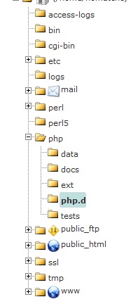

Here is my directory structure
There is no etc or php5 folders
I have already tried creating the php/php.d folder and placed apc.ini in there, and rebooted, but no joy.
Im thinking the main issue could be the php.ini as I cant see that, and when I try to create a new one the apc dashboard tells me apc isnt running :(
