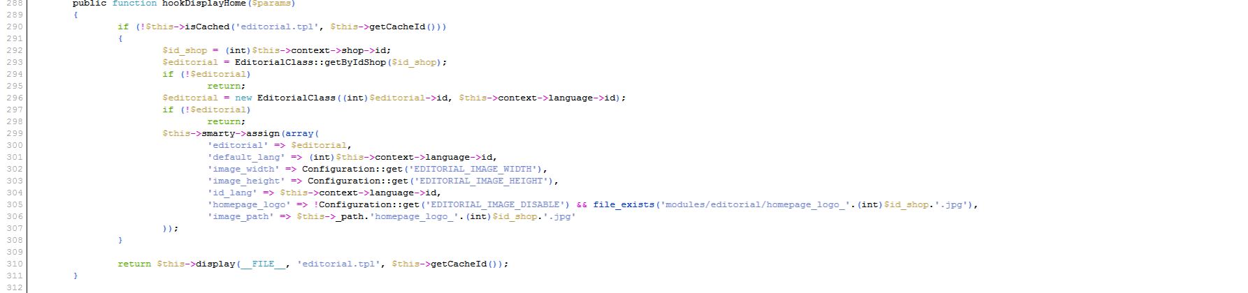

balburl Posted January 30, 2014 Share Posted January 30, 2014 I am getting this error code when I try to "View my Shop" from inside PrestaShop and also just going to the link. Please help! Fatal error: Call to undefined method Editorial::getCacheId() in /home3/songbir5/public_html/modules/editorial/editorial.php on line 290 I have attached a snip of the general area in this php file. Thanks for any help. Need to get my shop viewable!! Brenda http://songbirdsdesigns.com Link to comment Share on other sites More sharing options...

vekia Posted January 30, 2014 Share Posted January 30, 2014 i suppose that it will not work, as far as i remember prestashop 1.5.3 hasn't got cache support for modules, this is why new versions dont want to work. try with this: editorial.zip 2 Link to comment Share on other sites More sharing options...

vekia Posted January 31, 2014 Share Posted January 31, 2014 Can you explain a little about 1.5 modules that are not working with earlier versions of 1.5? Problem is related to Module.php class, old versions (below 1.5.4.1) Module.php file hasn't got getCacheId() function. A lot of default modules updated after 1.5.4.1 release use this function (for better performance), so this is why these modules don't want to work in old prestashop versions (below 1.5.4.1) Link to comment Share on other sites More sharing options...
