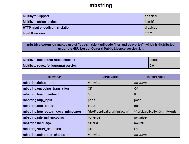

nikolaosp Posted February 22, 2014 Share Posted February 22, 2014 (edited) Hi, I was resolved with this issue. This issue was in extension of Web Hosting Manager (WHM) If you have access to WHM, follow this tutorial http://forums.cpanel.net/f5/enable-install-mbstring-module-158165.html to turn on the mbstring module. If you don't have access to WHM, ask your hosting provider to turn on the "mbstring extension" for you. I am running prestashop on my own server, and mbstring is already enabled. my phpinfo file has the screenshot Am i doing something wrong? Edited February 22, 2014 by nikolaosp (see edit history) Link to comment Share on other sites More sharing options...
nikolaosp Posted February 23, 2014 Share Posted February 23, 2014 I am running prestashop on my own server, and mbstring is already enabled. my phpinfo file has the screenshot Am i doing something wrong? so, it appears that the simplest explanation is always the last one you check... Although my site's folder was owned by www-data user and group, some subfolders of img folder where owned by another user. Don't know how this could happen, but there you go... It works now as it should . Link to comment Share on other sites More sharing options...
