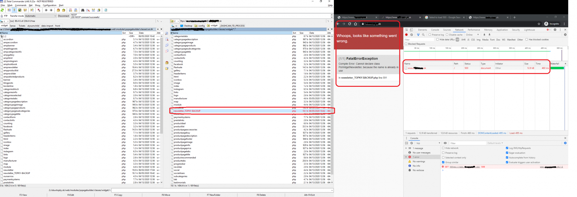

Martin Mi Posted June 10, 2020 Share Posted June 10, 2020 Hi everybody, In summary, this famous 500 error is the web server's way of saying "Oops! An error has occurred, but we can't tell you more." Therefore, if you have the same problem on your site and the error messages are too vague, you can activate your web host's FTP or CPanel error reports in your PrestaShop shop. Debugging: There are 2 ways to enable these reports, depending on the version you are using: » From PrestaShop v1.4 to v1.5.2 Open config/config.inc.php On line 29, you will find this line: @ini_set('display_errors','off'); Replace it with: @ini_set('display_errors','on'); » PrestaShop v1.5.3 and later versions (including 1.6 and 1.7) Open config/defines.inc.php On line 28, you will find this line: define('_PS_MODE_DEV_', false); Replace it with: define('_PS_MODE_DEV_', true); Example: There were similar symptoms on the server as most of people here described: back office was accessible without problems, front-end was giving HTTP 500 errors for IP addresses defined in the debugging mode but worked fine for all other IP addresses. By enabling debugging options as described above, the HTTP 500 error revealed to be caused by a duplicate PHP file that was made as a manual backup in classes directory of one of the modules in folder: web/modules/pspagebuilder/classes/widget I got this error FatalErrorException Compile Error: Canot declare class PsWidgetNewsletter, because the name is already in use Solution: The fix in this particular case consisted in removing the file completely. But as I still wanted to keep the backup copy, I opted to rename the *.PHP suffix of the duplicated file. Once done no HTTP 500 error was displayed as there were no duplicate PHP classes defined. All started to run smoothly. I hope this helps, Regards, Martin Mi DataQuo, s.r.o. www.dataquo.eu Link to comment Share on other sites More sharing options...
Anthony P Posted April 14, 2021 Share Posted April 14, 2021 (edited) Edited .. nevermind wow ... somehow, the very end of the file which there was no reason i would have ended up to the bottom ... was partially erased? What in the world? So I just unzipped the file file saved and went to the local tools folder and copied and pasted lol. Man this app is so buggy that it screws up locally hahaha. Please prestashop get on your app and make it easier on everyone. Edited April 14, 2021 by Anthony P Self-Fault (see edit history) Link to comment Share on other sites More sharing options...
