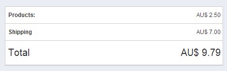

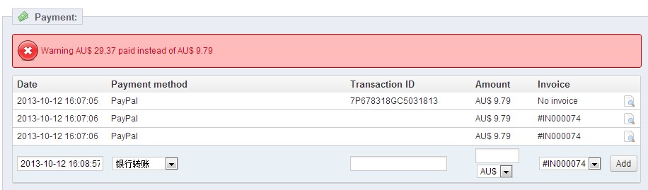

I have a servious problem for the payment module Paypal and COD.
After you made the payment through the two modules, it always shows double or triple amount paid instead of the real amount in the payment section of order detail page in admistration. It is very strange. It not happens to bank wire. I do not think it is something wrong with the module, maybe it is prestashop.

It seems that this issue is more related to statuses rather than payments.
I have observed that for COD the order gets status 'Preparation in progress' and upon order confirmation by customer the payment is automatically assigned to order, after you will update the status of the order, for example to Shipped/Delivered the same payment is assigned once more and doubles the payment.
In my case I have modified modules/cashondelivery/controllers/front/validation.php and commented line 59:
/* $this->module->validateOrder((int)$this->context->cart->id, Configuration::get('PS_OS_PREPARATION'), $total, $this->module->displayName, null, array(), null, false, $customer->secure_key);*/
and replaced it with:
    $this->module->validateOrder((int)$this->context->cart->id, Configuration::get('PS_OS_COD_VALIDATION'), $total, $this->module->displayName, null, array(), null, false, $customer->secure_key);
PS_OS_COD_VALIDATION is the status for 'Waiting COD Validation' from config/config.inc.php file
After testing the above mentioned modification the payment is not assigned after order confirmation by customer and once you will update the status of your order to Shipped/Delivered you will see only one payment.
In case you do not want to perform manual modification, another solution might be to untick 'Consider the associated order as validated.' and 'Set the order as paid.' checkboxes from Backoffice > Orders > Statuses > Preparation in progress (In this way the order is not marked as paid after confirmation).

The first status is "Payment Accepted" :)
It becomes marked as paid twice as soon as we set it to "In progress" which by default is set to mark the order as paid.

Try to untick the boxes ('Consider the associated order as validated.' and 'Set the order as paid.') of Payment Accepted status, save the changes, afterwards do a test transaction and change the status to In Progress.
Or leave the Payment Accepted status as it is and do the above changes for In Progress.

My solution. I had got duplicate payment for Paypall, Alipay and Weixin. Problem is that you have to generate Delivery Note at least one status before you set order as Paid.
Sample of statuses sequence:
PAYMENT RECEIVED - order cannot be set as paid (no delivery note no invoice). So you delivery note to be gererated in the next status.
ORDER ACCEPTED - order still cannot be set as paid - generate Delivery Note.
ORDER PROCESSING - because pdf i generated in previous order you can set order as paid.
This works for me in 1613
