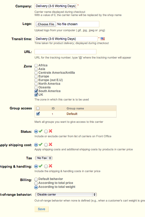

Brighteyes Posted September 27, 2013 Share Posted September 27, 2013 I've spent a few hours now trying to get shipping set up and i'm beginning to think there's a bug with the cart? I understand how the shipping works with zones/weight ranges etc so I have tried most of the obvious solutions to this. Here's the problem... I have different shipping costs according to weight. You can see in the screenshot that for a weight range between 100 - 1000 lbs UK postage should be £3.50 and South American £18.50. However no matter which South American country I select the shipping shows as £4.95. It's the same for any other zone. I'm using cart version 1.4.8.2 Hope someone can help! Link to comment Share on other sites More sharing options...
Dh42 Posted September 28, 2013 Share Posted September 28, 2013 I see in your image that you have both UK and south america selected. You need a separate carrier for each country if you want to have a different price. Link to comment Share on other sites More sharing options...

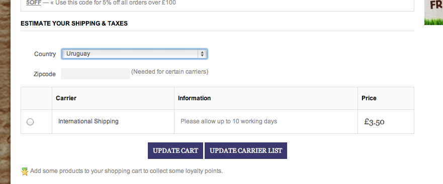

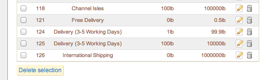

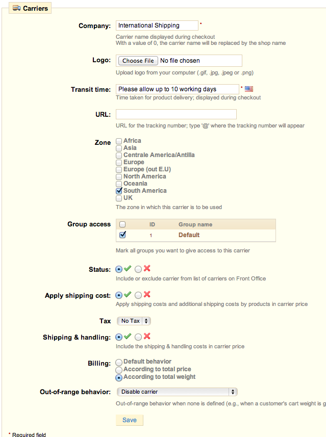

Brighteyes Posted September 28, 2013 Author Share Posted September 28, 2013 Thanks for your reply. That doesn't seem to make a difference? I have now made South America a separate carrier called 'International Shipping'. Can you see anything wrong with this setup? Surely, any South American country should be charged £18.95 where in fact they are being charged £3.95 (which is the UK price). Link to comment Share on other sites More sharing options...
Brighteyes Posted September 29, 2013 Author Share Posted September 29, 2013 It turns out that the problem is with the Shipping Estimator module. When you checkout the shipping costs are ok. Has anyone else had problem with this? I've disabled but could do with on the site. Link to comment Share on other sites More sharing options...
