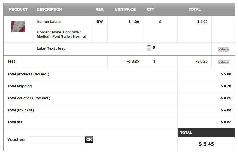

Rizzo Posted September 20, 2013 Share Posted September 20, 2013 So I set up a cart rule for 5% off - then tested it. I added 5 products worth $1 to my cart. Total $5 I applied the voucher code, and discount of 0.25 appears. Now new total is $5.45 - This is obviously not right. How do I sort this? Link to comment Share on other sites More sharing options...
vekia Posted September 21, 2013 Share Posted September 21, 2013 you've got there also shipping cost, so everything looks fine in my opinion Link to comment Share on other sites More sharing options...

Rizzo Posted September 22, 2013 Author Share Posted September 22, 2013 you've got there also shipping cost, so everything looks fine in my opinion so everything looks fine in my opinion Thanks you're both quite right - it does seem right. I am sorry to have wasted your time! Link to comment Share on other sites More sharing options...

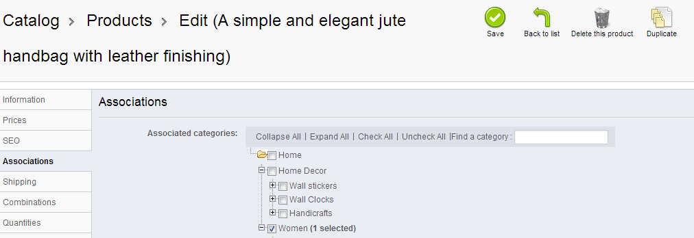

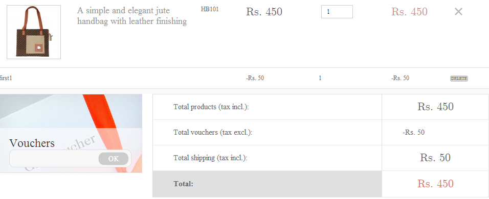

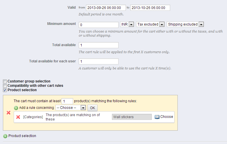

PrestaFanBoy Posted September 26, 2013 Share Posted September 26, 2013 Hi, I have similar problem. Cart rule not applying properly. In my case, I have selected cart to e applied for one specific category, Wall stickers. However, it is applying for every category. Im not sure if i didnt configure it properly. I have attached the screen shot. If you look at front office, it is applying for handbags category. My shop: omytus.com Can anyone suggest me. Thank you. PrestaFanBoy Link to comment Share on other sites More sharing options...
vekia Posted September 26, 2013 Share Posted September 26, 2013 voucher code configuration looks well so your product isn't attached to wall stickers category? Link to comment Share on other sites More sharing options...
PrestaFanBoy Posted September 26, 2013 Share Posted September 26, 2013 (edited) voucher code configuration looks well so your product isn't attached to wall stickers category? Hello Vekia, Thank you for the reply. Yes, the handbag is not attached to the wall stickers category. But still the voucher is getting applied to handbag. Its even applying to wall clocks..just everything that i tried. I was expecting some kind of error when applied on other categories. Im using PS 1.5.3.1. No clue, i was planning to offer some promotional thing and suddenly I found this. PrestaFanBoy Edited September 26, 2013 by PrestaFanBoy (see edit history) Link to comment Share on other sites More sharing options...
