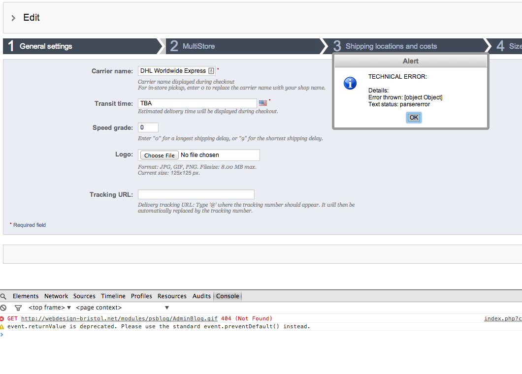

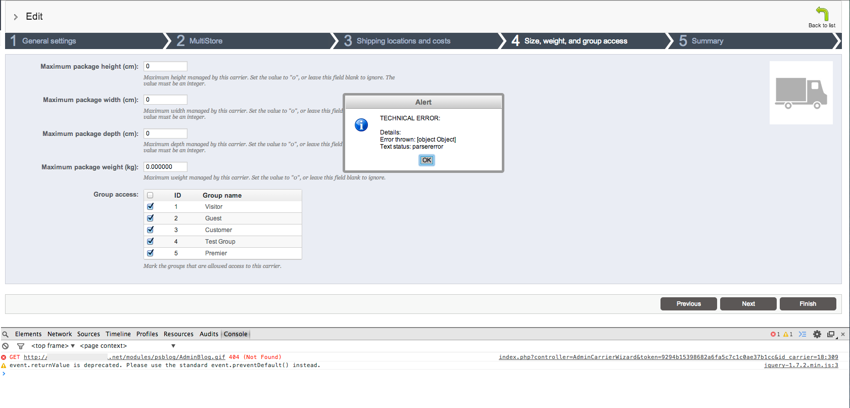

Teapot Creative Posted February 24, 2014 Share Posted February 24, 2014 (edited) Hi We have similar issue: When we try to finish the Carrier Wizard we are getting this error, please see console screen grab. Nick Edited February 24, 2014 by Teapot Creative (see edit history) Link to comment Share on other sites More sharing options...
