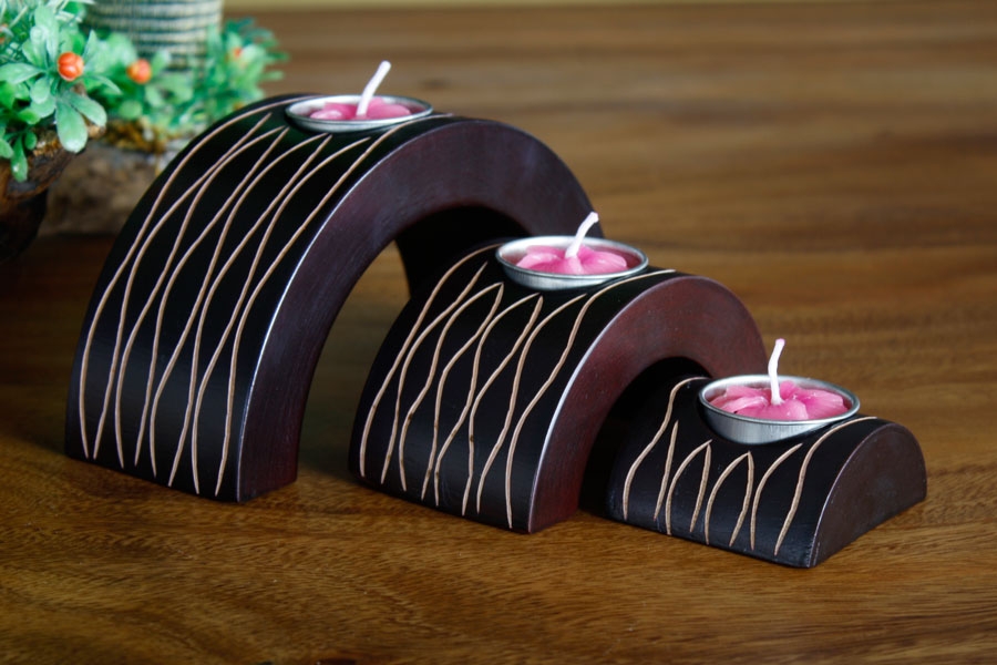

ALEXCNX Posted September 18, 2013 Author Share Posted September 18, 2013 Hi Pascal, I hope you're doing well : ) I am talking about the large images, which format is jpeg. If I download a large image (either from the products in the back-office or from the site), the dimensions are the same but the size is larger than the original. For example the size of the image here. is 280Kb whereas the original is only 100Kb. Note that there an "easy zoom" feature installed. Thanks, Alex Link to comment Share on other sites More sharing options...

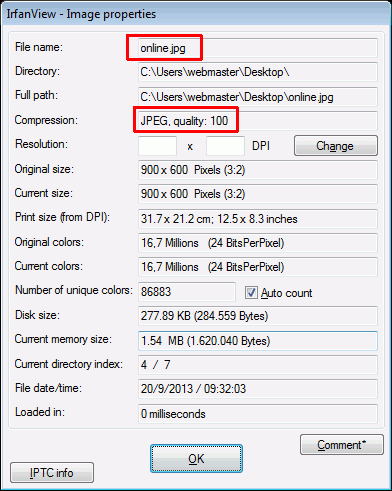

parsifal Posted September 20, 2013 Share Posted September 20, 2013 (edited) Under preferences > images, I've decreased the jpg quality to 50 but the size remains the same ALEXCNX, for some reason the change didn't take and PS still applies a compression with JPEG quality set at 100. Check what IrfanView says about your 2 attached pics: Edited September 20, 2013 by parsifal (see edit history) Link to comment Share on other sites More sharing options...
