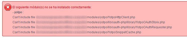

Hi, I've got the same problem with PS 1.5.4.0 and yotpo 1.2.9.
I've tried to fix it, there are clearly some bugs and confusion between $this->_path and $this->_yotpo_module_path (at line ~100 in yotpo.php).
 foreach ($this->_required_files as $file)
            if (!file_exists($this->_path.$file))
                $this->setError($this->l('Can\'t include file '.$this->_yotpo_module_path .$file));
Once changing here and there the path I could install the yotpo module, clicking on Configure gives me no form or whatsoever to configure yotpo (still have the PS menu though).

I'm trying to install yotpo 1.2.9 and I received this error:
after this error message (after clicking on "install"), your yotpo module is installed?
No, It isn't installed

Thank you all for bringing this to our attention. Prestashop made an update to Yotpo without our knowledge which created a conflict with updating/installing Yotpo, we are now working on getting an updated version sent to Prestashop. We will post updates regularly.
Some good news. Our QA just gave us the green light to provide you with version 1.3.0 which you can use to override the problematic version.
Visit the link below, download the zip and override your current version to successfully install Yotpo in your Prestashop store.
https://s3.amazonaws.com/yotpo-presta-shop/yotpo.zip
Please let us know if you experience any issues with this fix.
Thank you for your patience and understanding.
