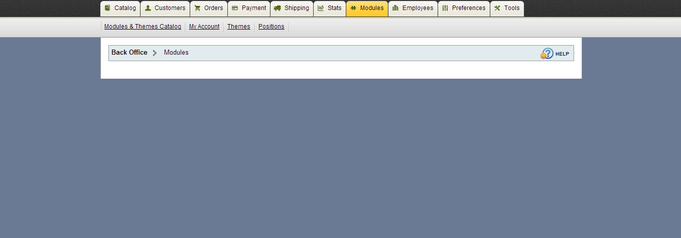

ShanM Posted September 5, 2013 Share Posted September 5, 2013 To cut to the chase, I may have done something terribly stupid which has messed up my module page. I have PrestaShop V 1.4.4.1. Yes, I know it's outdated, but if it ain't broke don't fix it lol. Anywho, my version of the Canada Post module appeared to be "broke" as it was not show up during the check out process. I have configured it on the Canada Post end as well as in the back office. That being said, I went searching for a fix and came upon this topic - http://www.prestashop.com/forums/topic/145262-canada-post-shipping-module-5-seconds-delay/?do=findComment&comment=714782 and a download link to Canada Post 0.8. I decided to try an upgrade hoping it would solve the issue out-right. I tried to upload the downloaded ZIP file it in the back office. Now my module page is no longer showing any modules... Was I supposed to unpack the file before trying to upload? What are my options for fixing this? Thank you to anyone who might be able to give me some insight. Link to comment Share on other sites More sharing options...
vekia Posted September 5, 2013 Share Posted September 5, 2013 open: config/config.inc.php find this line@ini_set('display_errors', 'off'); change to look like this:@ini_set('display_errors', 'on'); then open modules page once again - you will see error code then - paste it here, it will be really helpfull Link to comment Share on other sites More sharing options...
ShanM Posted September 6, 2013 Author Share Posted September 6, 2013 Didn't realize I would get a reply so quickly! Thank you =) So this is what it now says. Warning: require(/home1/ksplus/public_html/Shop/classes/backward_compatibility/backward.php) [function.require]: failed to open stream: No such file or directory in/home1/ksplus/public_html/Shop/classes/Module.php(551) : eval()'d code on line 68Fatal error: require() [function.require]: Failed opening required '/home1/ksplus/public_html/Shop/classes/backward_compatibility/backward.php' (include_path='.:/usr/lib/php:/usr/local/lib/php') in /home1/ksplus/public_html/Shop/classes/Module.php(551) : eval()'d code on line 68 Link to comment Share on other sites More sharing options...
vekia Posted September 6, 2013 Share Posted September 6, 2013 it looks like /classes/backward_compatibility/backward.php file doesnt exist, can you verify it? Link to comment Share on other sites More sharing options...
ShanM Posted September 6, 2013 Author Share Posted September 6, 2013 Yes it seems I don't have the folder and file. "backward_compatibility/backward.php" Just to mention. I don't seem to have it in a very old backup of my shop either. Link to comment Share on other sites More sharing options...
vekia Posted September 6, 2013 Share Posted September 6, 2013 it's probably because module trying to use this file. are you able for test purposes remove this addon from FTP ? Link to comment Share on other sites More sharing options...
ShanM Posted September 7, 2013 Author Share Posted September 7, 2013 Ah, my module page is back after removing canada post Thank you very much, that was quite worrisome lol. But, where do I go from here? Should I fully upgrade my shop and is there a free/default version of canada post with the new versions? I've read that with the newer versions of PS your only option is to pay 75$ if you want to buy the module from the forge, this being the main reason I want to stay away from the upgrading part.... Link to comment Share on other sites More sharing options...
