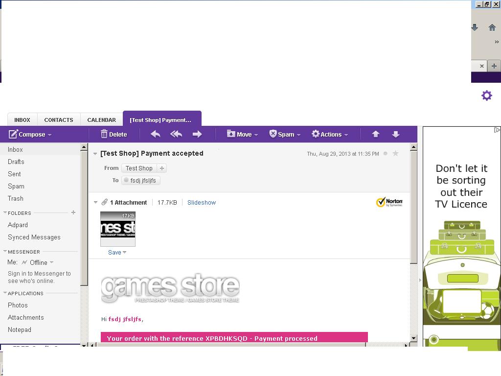

Jiten rash (away) Posted August 31, 2013 Share Posted August 31, 2013 can u please show on a screenshot Link to comment Share on other sites More sharing options...
avtuk Posted August 31, 2013 Share Posted August 31, 2013 Please find attached. I don't want to attach my website's logo to every email sending out to customers. Thanks. Link to comment Share on other sites More sharing options...
